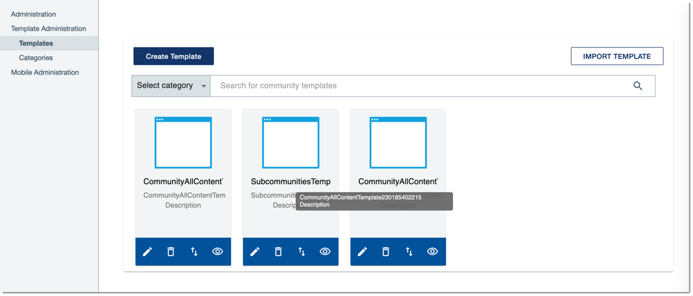

The deployment
community-template-serviceuses Mongo3. Before starting to migrate data from Mongo3 to Mongo5, the following three templates are created as follows:
As Mongo3 is in use, these templates are stored in the Mongo3 database.

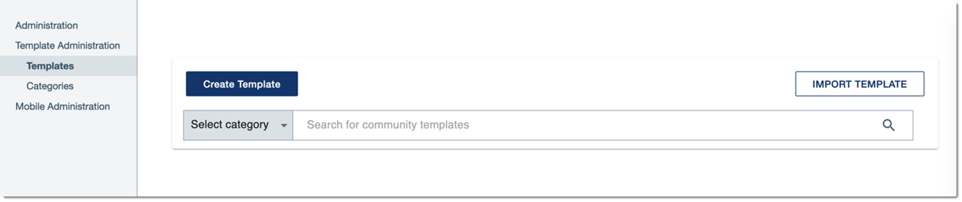

community-template-serviceto use Mongo5.kubectl -n connections edit deployment community-template-service Edit the following to mongo5 : - name: MONGODB_HOST value: mongo5 ...... - name: MONGO_RS_MEMBERS_HOSTS valueFrom: configMapKeyRef: key: mongo5-rs-members-hosts name: connections-env -
Since there is no data created and migrated in Mongo5 yet, the database used for
community-template-serviceis blank.
Perform the previous data migration procedure and verify the
community-template-servicescreen. If the steps are correctly done, the community-template-service screen should populate the data from Mongo3, as seen in step 5a.
