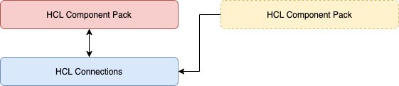

Once the process is complete, you have a second Kubernetes cluster pointing to the Connections cluster, but the data still lives in the first Kubernetes cluster, which is still used by Connections for serving requests, as in this diagram:
