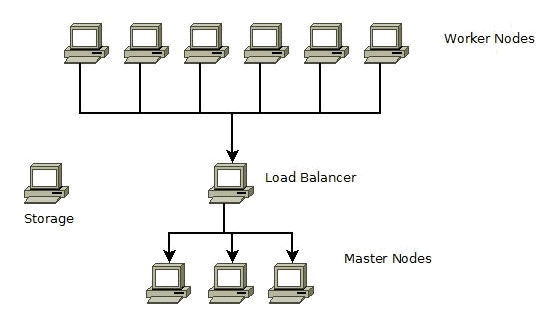

Architecture: The following image shows the recommended architecture of an HA Kubernetes deployment, which includes the following servers:
  • 6 worker nodes communicate with a Kubernetes master through the load balancer.
  • The load balancer routes requests to the api-server onto a master node in round-robin fashion.
  • The load balancer can also function as a reverse proxy server for the HCL Connections™ Customizer component.
Component Pack architecture for an HA deployment
