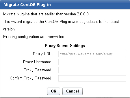

- Click Migrate.The Migrate CentOS Plug-in wizard displays.
Figure 1. Migrate CentOS download plug-in wizard
- Enter the proxy parameters if the
downloads must go through a proxy server.Note: Only basic authentication is supported. Ensure that the proxy is configured to work with the Transport Layer Security (TLS) protocol.
- Proxy URL
- The URL of your proxy server. It must be a well-formed URL, which
contains a protocol and a host name. The URL is usually the IP address
or DNS name of your proxy server and its port, which is separated
by a colon. For example:
http://192.168.100.10:8080
- Proxy Username
- Your proxy user name if your proxy server requires authentication.
It is usually in the form of
domain\username
- Proxy Password
- Your proxy password if your proxy server requires authentication.
- Confirm Proxy Password
- Your proxy password for confirmation.
