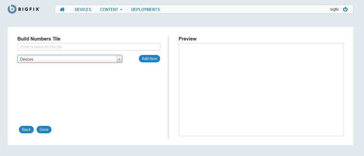

Select a custom tile from the Edit Dashboard page to display the Build Tile page.
- Entering a title for the tile. The Preview area on the right side of the page shows the tile-in-progress.

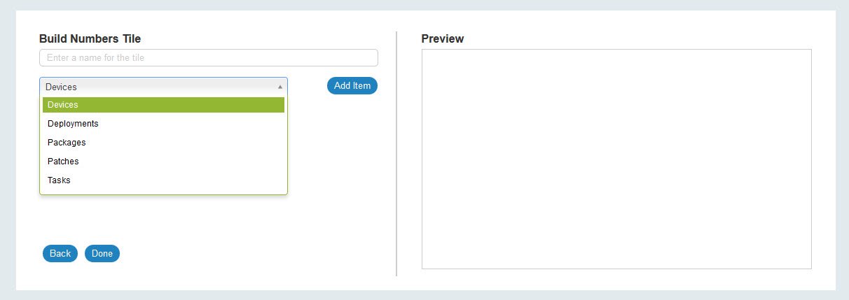

- Select a BigFix object from the Build Tile drop-down list:
- Devices
- Deployments
- Packages (Software)
- Patches
- Tasks (Custom Content)

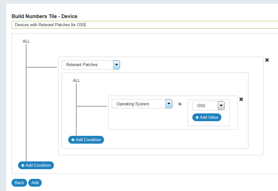

You can display data on a tile based on more than one high-level object using a complex filter. Complex filters appear at the end of an object's Condition list.
- Devices: Deployments
- Deployments: Targeted Devices, Source Tasks, Source Packages, Source Patches.
- Packages (Software): Deployments
- Patches: Deployments
- Tasks (Custom Content): Deployments, Targeted Devices.
In a complex filter the condition box is nested inside the top-level object.
A basic understanding of how complex filters are processed will help you use them effectively.
- A query is performed on each top-level object: some combination of Devices, Patches, Software Packages, Tasks, and Deployments. Every instance of each condition specified is found.
- A set intersection on the results of both queries is created using an identifier common to both, and the results are returned to you. For example, a complex filter that involves devices creates a list of Device IDs that meet the conditions specified for each object. The set of Device IDs common to both lists is returned.

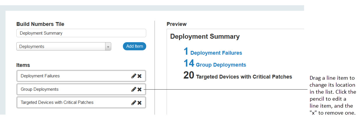

- On the Build Tile page, drag a line item to change its order in the Items list. Click the X to delete it.
- Click the pencil icon to edit a line item.
