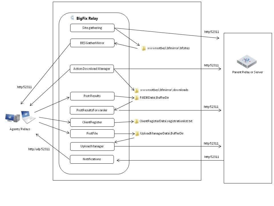

How do BigFix Relays work?
  • BigFix Relays are BigFix Clients that are running two extra services (BESGather and BESRelay).
  • BigFix Relays act as a mini BigFix-specific webserver.
  • BigFix Clients connect using standard HTTP on the specified port number (default 52311).
  • BigFix Clients will request downloads, the latest Fixlet sites, and the latest action sites from the BigFix Relay.
  • If the BigFix Relay does not have the latest information, it gets the data from another BigFix Relay or from the BigFix Server.
  • BigFix Clients will send action results and retrieved property reports to the BigFix Relay, which will bundle and compress them and send them to another BigFix Relay or to the BigFix Server (the bundling and compression also saves network bandwidth).
  • BigFix Relays will cache downloaded files so that it will not have to re-download the files if they are needed later. BigFix Relays (default cache size is 1 GB, but is configurable) use a least-recently-used (LRU) cache replacement scheme for when the cache fills up.
