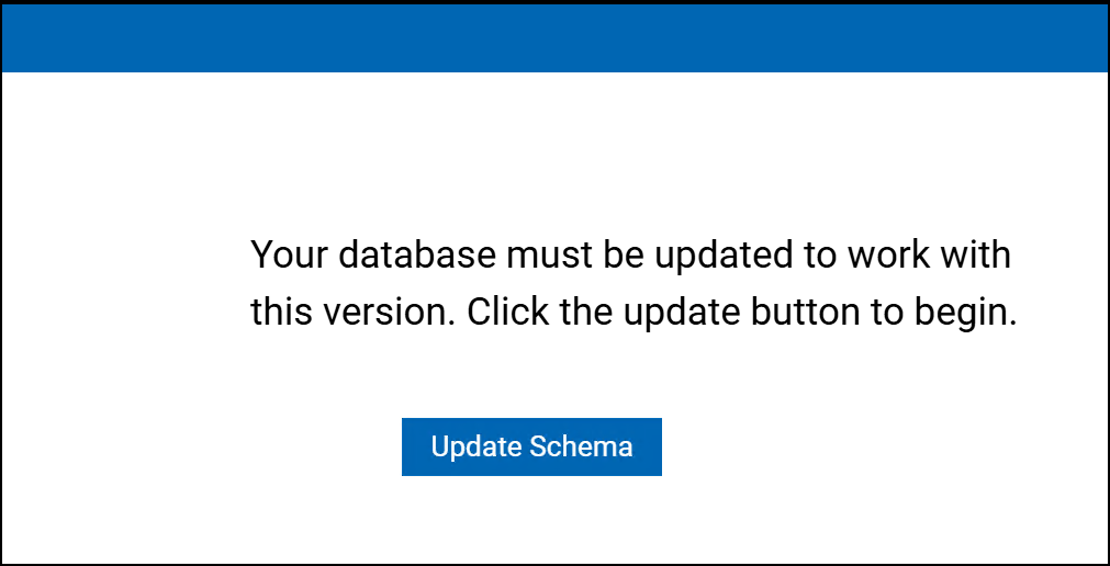

When upgrading from an earlier version, you also need to update the data schema. To do this, the operator should log in to the Security and Compliance Analytics web interface on the server that hosts Security and Compliance Analytics. Then, click Upgrade Schema.
Figure 1. Upgrade Schema
Upgrade Schema
It is highly recommended, especially in large environments, to first test the upgrade in a test environment. To do this, back up your production database, restore it on the test server, and perform the upgrade there. If the upgrade is successful, you can then proceed to upgrade the production server.
