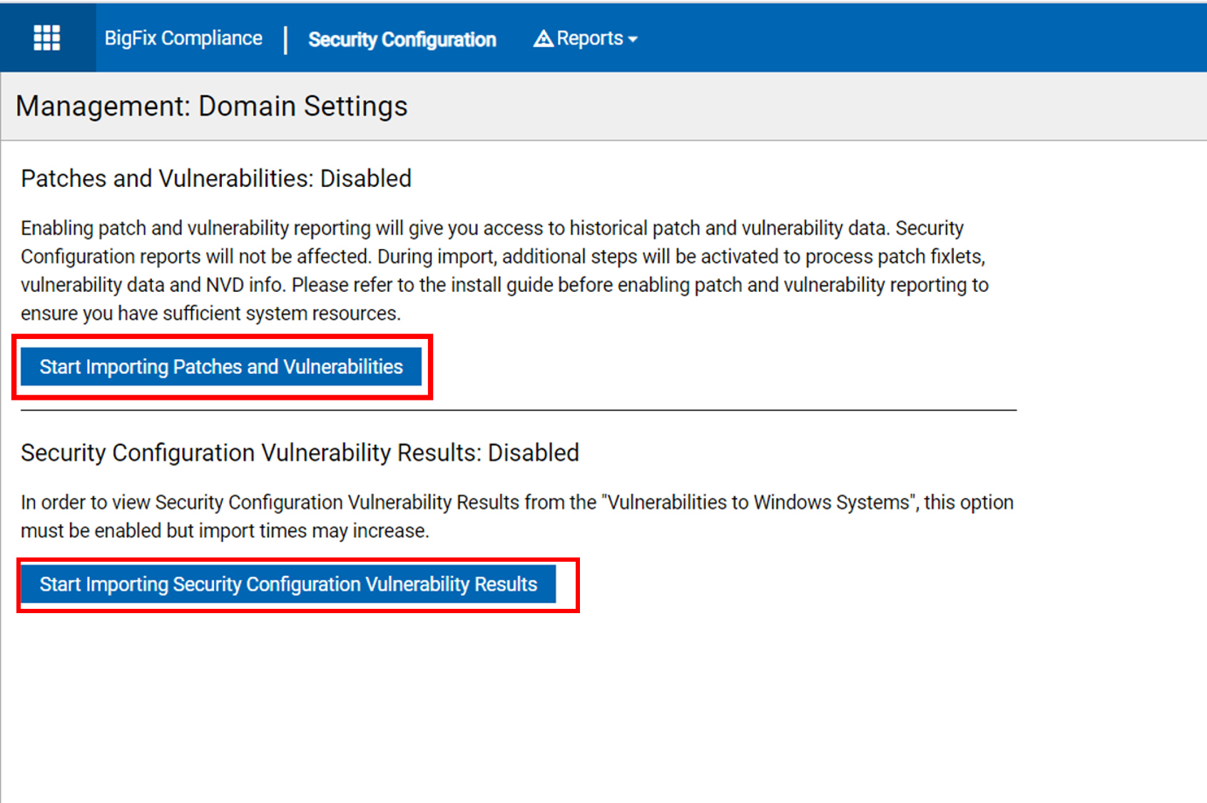

Domain Settings
You can enable the patch and vulnerability report, and security configuration report using the Domain Settings.
Enabling patch and vulnerability reporting will give you access to historical patch and vulnerability data. Security Configuration reports will not be affected. During import, additional steps will be activated to process patch fixlets, vulnerability data and NVD info.
If must enable Security Configuration Vulnerability Results to view the vulnerabilities to Windows systems.
To enable the Patch and Vulnerability Report, and Security Configuration Vulnerability Results:
- On the header bar, click Management Gear Icon.
- Select Domain Settings from the menu.
- Under Patches and Vulnerabilities, click Start Importing Patches and Vulnerabilities.
- In the window that opens, click Yes, include to enable the patch and vulnerability reporting.
- Under Security Configuration Vulnerability Results, click Start Importing Security Configuration Vulnerability Results.
- In the window that opens, click Yes, include to enable Security Configuration Vulnerability Results.
