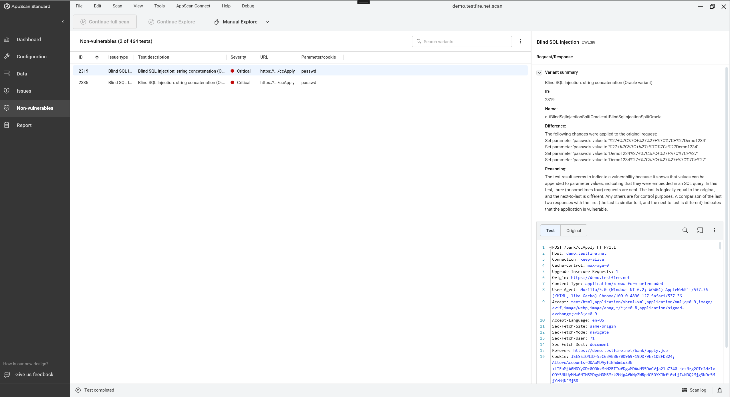

Non-vulnerables list
The Non-vulnerables list lets you view details of non-vulnerable test variants that have been saved with the scan results. You can set a test variant as vulnerable if AppScan incorrectly marked this test as non-vulnerable.
You can view this list only if AppScan® is configured to save non-vulnerable test variant information (see Test options)
Viewing non-vulnerables
  1. On the View menu, click Non-vulnerables.
    By default, the Non-vulnerables list is not displayed on the Navigation bar. However, once you view them, it is displayed.
