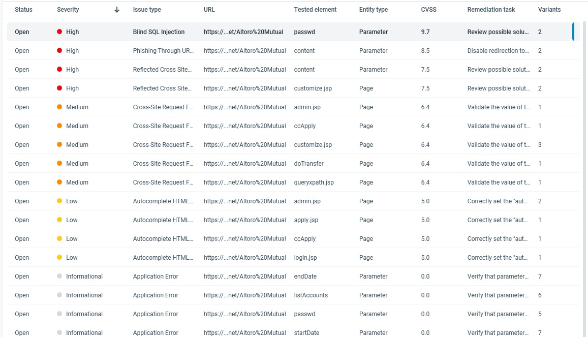

The Result List displays the issues relevant to the node selected in the Application Tree. If you selected the My Application node, the Result List shows all issues found in your web application.
Issues are grouped by Type. Under each Type, all URLs are listed. Under each URL, all issues are listed. (Individual variants of issues are not shown in the Result List, but can be seen from the Detail pane.)
Each node in the tree has a severity icon, indicating issue severity; and a counter, indicating how many issues of this type were found. In the case of Type and URL, the severity icon indicates the severity of the most severe issue included under the node.
You can change the way the issues are sorted, and you can manipulate their severity value (see Issue severity levels).
You can designate issues you do not want to deal with currently as Noise, either removing them from the result display altogether, or having them appear with strikethrough (see Issue state: Open or Noise).
