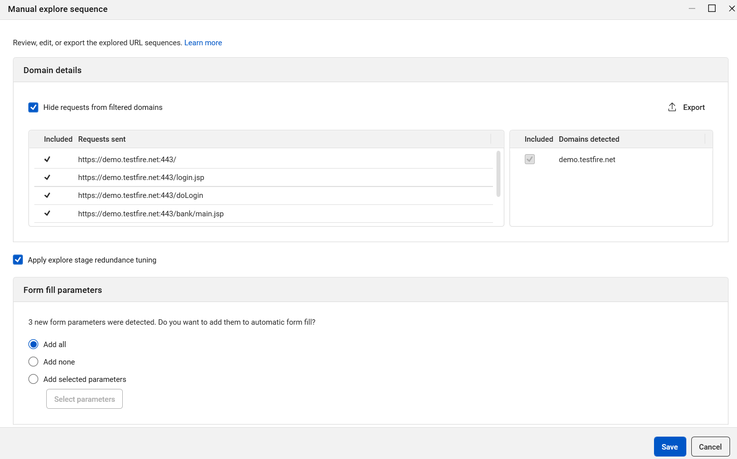

Working with the Manual Explore sequence
Reviewing and editing and exporting the sequence.
  1. You can delete any unwanted steps (links) in the sequence by using Delete option from the vertical three dot menu vertical three dot menu.
  2. Review the list.
    If the Manual Explore performed is a standard procedure for the site, you may want to save it for use in future scans. For details see Exporting Manual Explore data.
    If you filled HTML forms during the Manual Explore, AppScan determines which information can be added to the Automatic Form Filler settings. If applicable input is found a message appears in the lower half of the dialog-box, and the radio buttons are activated:
    [n] new form parameters were detected. Do you want to add them to automatic form fill?
    • If you want all your recorded input to be added to the Automatic Form Filler, click Add all. Your input is added automatically to the Form Filler information.
    • If you do not want your recorded input to be saved, click Add none. Even if it is not permanently saved, your manual input has already been applied.
    • If you want to add only selected parameters and values, click Add selected parameters, and then click Select parameters. The Add auto-detected form parameters dialog box appears (see Add automatically detected form parameters).
  3. Click Save.
    AppScan creates the test requests of your Manual Explore. This may take a few moments.
