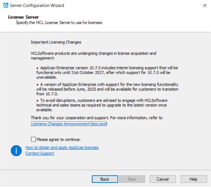

  3. In the License Server window, review the licensing changes information and agree to proceed.
    Do not check the AppScan Source standalone evaluation check box.

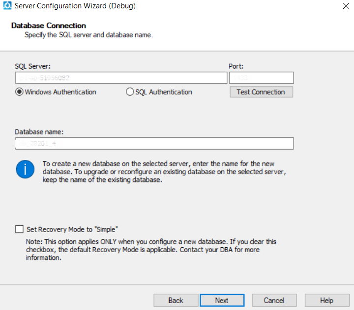

  7. In the Database Connection window, enter the SQL Server name, port number, select the authentication mode and the name of the database you are connecting to. If you select SQL Authentication, enter the username and password before you click Test Connection to verify that you can connect to the SQL Server. The configuration wizard does not proceed until the connection is successful. When AppScan® Enterprise Server creates the database in SQL Server, it automatically configures the collation for it.
    1. AppScan Enterprise supports Windows Authentication and SQL authentication to connect to SQL Database. Refer to Microsoft's article on Authentication Mode and choose the authentication mode that fits your requirement. You can change from one authentication mode to another, but make sure to re-run the configuration wizard.
    2. The user must be assigned a sysadmin server role on the SQL server. The user must also have access to the database and must be granted a minimum of db_ddladmin, db_datawriter, and db_datareader rights or the db_owner rights.
    3. The syntax for the SQL Server name has changed with the introduction of Liberty support. ".\SQL_SERVER_NAME" no longer works. Use "HOSTNAME\SQL_SERVER_NAME" instead.
    4. If you are upgrading an existing database from v8.6 or earlier, enter the Database Master Key Password on the next screen to access it. Keep this password in a secure location.
    5. If your environment uses a named SQL Server instance for the AppScan Enterprise database, make sure that TCP/IP is enabled in the SQL Server configuration manager, and restart the SQL services for SQL Server. Use the port number of the named SQL Server instance instead of the default port number (1433).
