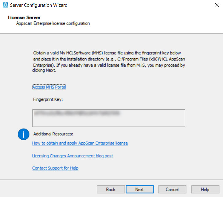

Running the Configuration wizard to get the fingerprint key

  1. When the installation is complete, the Configuration wizard launches automatically. You can also start it by selecting Configuration Wizard from the Windows™ Start menu as an administrator.
  2. In the Welcome screen, click Next.
  3. In the License Server window, copy the Fingerprint Key displayed on the screen. This key is unique to your machine and is required to generate a valid license.
Generating and applying the license file
This task covers the steps to generate and apply a license file for AppScan Enterprise, including generating, configuring, and placing the license file.
Ensure that you have a deployment with an allocated license in MHS. Refer to Configuring licensing in HCL AppScan Enterprise via MHS
  1. Generating the license file:
    1. Go to MHS portal > Deployment.
    2. Find your existing deployment and click the three-dot menu next to the deployment.
    3. Click Download License File.
    4. In the Download License File window, paste the Fingerprint key (copied from the Configuration wizard or the standalone utility).
    5. Once done, click Submit to download the license file.
  2. Applying the license file:
    1. Copy the downloaded license file to the AppScan installation directory (e.g., C:\Program Files (x86)\HCL\AppScan Enterprise).
    2. The file name must be AppScanEnterprise_License.license.

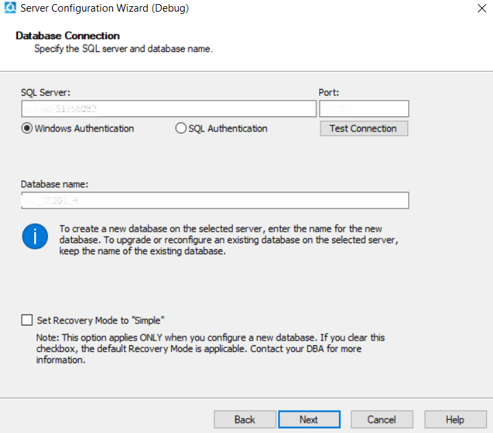

  1. During configuration, you define the name and location of the SQL Server database to be used, and the service account name and password. The user who runs the configuration wizard must be able to create a database and grant rights.

  7. In the Database Connection window, enter the SQL Server name, port number, select the authentication mode and the name of the database you are connecting to. If you select SQL Authentication, enter the username and password before you click Test Connection to verify that you can connect to the SQL Server. The configuration wizard does not proceed until the connection is successful. When AppScan® Enterprise Server creates the database in SQL Server, it automatically configures the collation for it.
    1. AppScan Enterprise supports Windows Authentication and SQL authentication to connect to SQL Database. Refer to Microsoft's article on Authentication Mode and choose the authentication mode that fits your requirements. You can change from one authentication mode to another, but make sure to re-run the configuration wizard.
    2. The user must be assigned a sysadmin server role on the SQL server. The user must also have access to the database and must be granted a minimum of db_ddladmin, db_datawriter, and db_datareader rights or the db_owner rights.
    3. If you are upgrading an existing database from v8.6 or earlier, enter the Database Master Key Password on the next screen to access it. Keep this password in a secure location.
    4. If your environment uses a named SQL Server instance for the AppScan Enterprise database, make sure that TCP/IP is enabled in the SQL Server configuration manager, and restart the SQL services for SQL Server. Use the port number of the named SQL Server instance instead of the default port number (1433).

  3. In the License Server window, click Next.

  6. In the Database Connection window, enter the SQL Server name, port number, select the authentication mode and the name of the database you are connecting to. If you select SQL Authentication, enter the username and password before you click Test Connection to verify that you can connect to the SQL Server. The configuration wizard does not proceed until the connection is successful. When AppScan® Enterprise Server creates the database in SQL Server, it automatically configures the collation for it.
