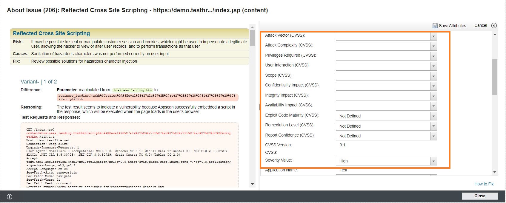

  3. If the Base metrics (Attack Vector, Attack Complexity, Privileges Required, User Interaction, Scope, Confidentiality Impact, Integrity Impact, Availability Impact) display as unknown (blank), select a value for each of them.
    In this screen capture, the CVSS Base metrics are unknown, there is no CVSS score, and the issue severity is High.
    The About this Issue dialog for an issue.
  4. Change the Severity Value to Use CVSS.
    If you only change the Severity Value but you don't change the Base metrics, the issue is categorized in the issue list as Undetermined, which means that the severity formula cannot accurately calculate the severity because information that it uses in its calculation is missing.
