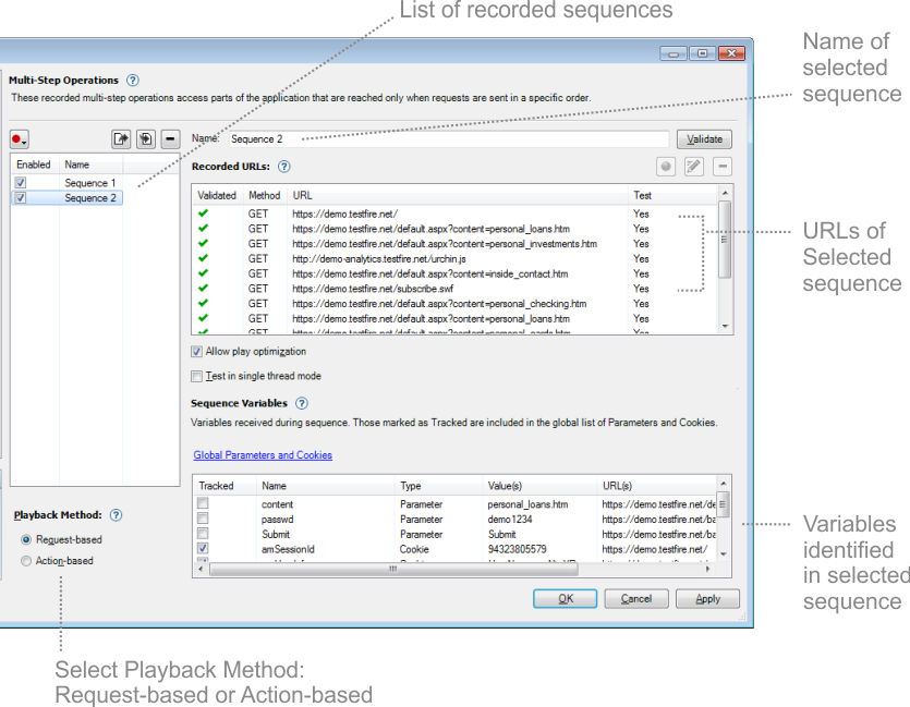

Setting Details
Record
Click to record a new sequence.
For applications, see Using a browser
For web services see Using an external client
export button | import button | minus button
Export a sequence (as an SEQ file) for use with a different scan; import a sequence (SEQ file) exported from a different scan; delete the selected sequence from the current scan.
Playback Method
When you record a multi-step operation, AppScan records both the actions and the requests. You can select which of them will be used for the scan:
Request-based playback
Sends the raw HTTP requests from the recording. This method is usually faster.
Action-based playback
Replays the clicks and keystrokes of the user. Reasons for selecting this method could be that the site includes a lot of JavaScript, or that some of the requests in the request-based playback were marked with a red X when you attempted to validate them. This method can increase scan time.
Request-based playback is the default method.
If the scan is configured not to use a browser other than the embedded browser (Tools > Options > Use external browser), request-based playback is always used.
If you load a sequence that was recorded in a version of AppScan that did not support action-based playback, request-based playback is used for that sequence, even if action-based playback is selected.
Sequence Name
The name of the sequence that is selected in the List of Sequences.
The check box next to each name indicates if the sequence is enabled for this scan.
Sequence
Shows the links in the selected sequence.
  • Click Validate to check that the sequence is valid. AppScan replays the sequence, and any requests that receive a response different to the original response are marked with a red X, indicating that they will not be tested.
    A common reason for requests receiving a different response is the presence of a dynamic sequence variable that needs to be defined, see Sequence variables
  • View any link in the sequence by selecting it and then clicking the browser button
  • Delete any link in the sequence by selecting it and clicking minus button. After doing this click Validate to check that the sequence still keeps in-session.
  • Right-click on one or more of the steps in the Sequence pane and select Don't Test. They will still be included when playing the sequence, but will not be tested individually.
Allow play optimization
(Request-based playback only) When selected (default) AppScan® attempts to optimize scan time by avoiding unnecessary playback. You should not disable this setting unless you find that AppScan® is missing parts of the application due to play optimization.
Test in Single-Thread mode
AppScan® may send two or more requests simultaneously, if they don't require the replaying of a sequence between them. If this results in parts of the application being missed, select this check box.
Sequence Variables
Lists variables that were received while recording the sequence(s), and indicates those that AppScan® has determined should be tracked. These may be session IDs or other variables. You can change the status of variables in this list to improve how AppScan® deals with them (for details see Sequence variables).
