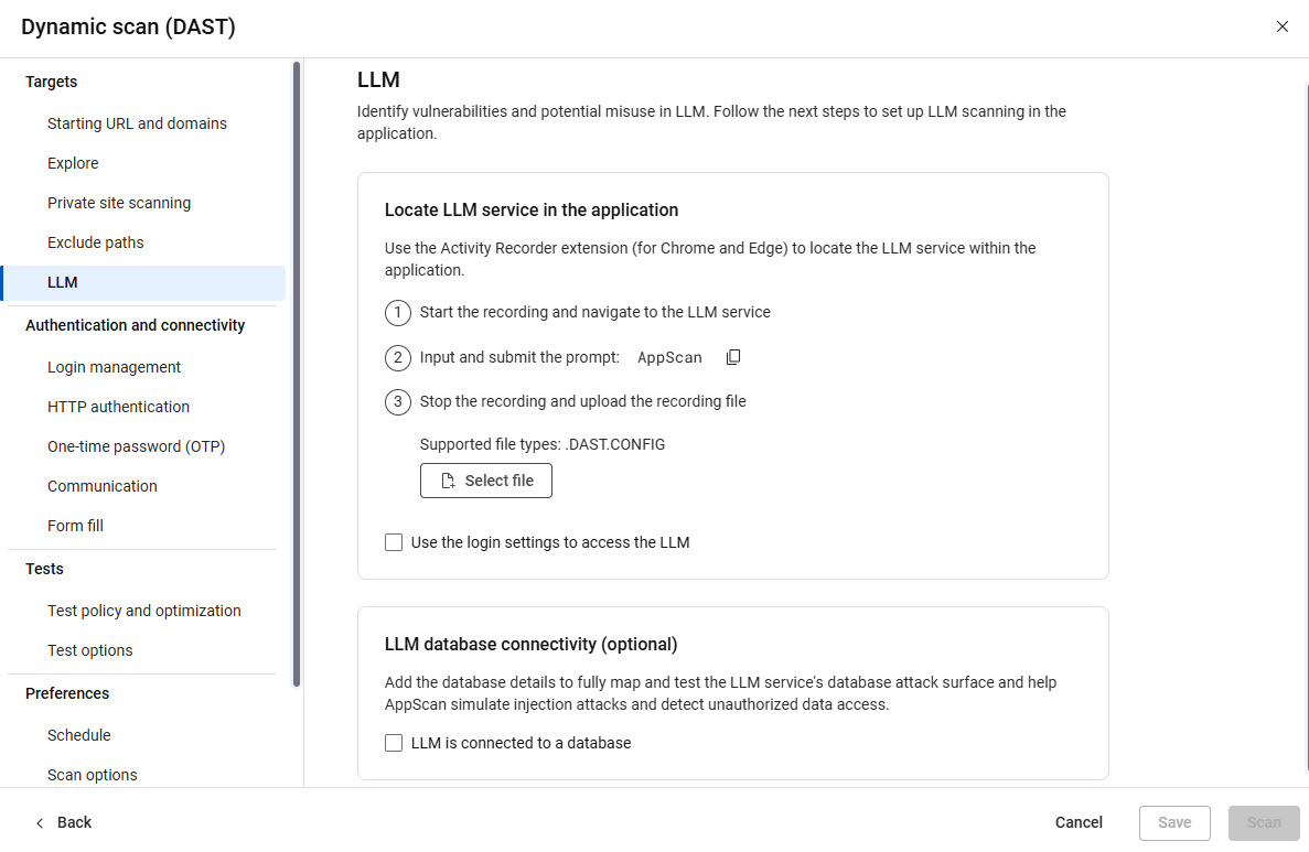

  6. Targets: LLM
    Dynamically test Large Language Model (LLM) features in your application to detect critical vulnerabilities such as sensitive information disclosure, prompt injection, and more.
    Scan configuration showing LLM configuration option
    Setting
    Options
    Locate LLM service in the application
    • Follow the on-screen steps. When the recording is ready, click Select file and upload the LLM recording. For more information, see Configure and run an AppScan LLM security scan.
    • Use the login settings to access LLM: Select this checkbox to have AppScan 360° use the login management settings to access LLM.
    LLM database connectivity (optional) Select the LLM is connected to a database checkbox, then enter the name of the connected database table to fully map and test the LLM service’s database attack surface. AppScan uses this information to simulate injection attacks and identify vulnerabilities that could allow unauthorized data access.
