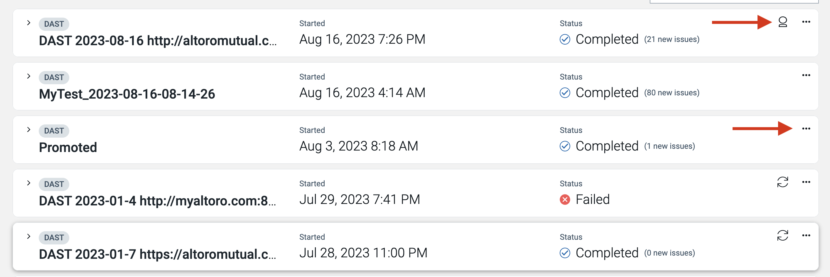

A personal scan is a way of evaluating the relative security of an application in development without affecting overall application scan data (issues, for example), or compliance.
A personal scan appears in the list of scans for the application, but issues found in personal scans are not merged with the rest of the application results. Just as with a regular scan, you can download reports on personal scans.
In the Scan List, a personal scan is identified by the personal scan icon: Results from personal scans look the same as results from regular scans in the scan data, but are not consolidated with the issue management pool of results. Therefore indications like application compliance are not affected by personal scans.

Any scan can be designated a personal scan. In the last step of the configuration, select the Run as a Personal Scan check box.
Note: A personal scan is deleted after 30 days, unless you promote it within that time.
Promote a personal scan
To add the results of a personal scan to the results for the application as a whole, from the vertical three-dot menu for the personal scan, select Promote.
