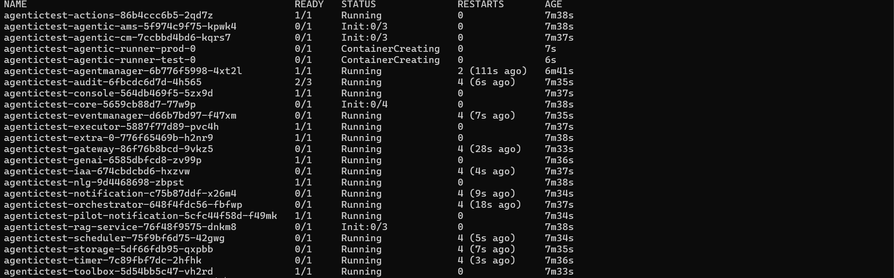

Verification
Run the following command to check the pod status in your namespace:
kubectl get pods -n <namespace>
You should see output similar to this:
Init or
ContainerCreating state.Solution:
