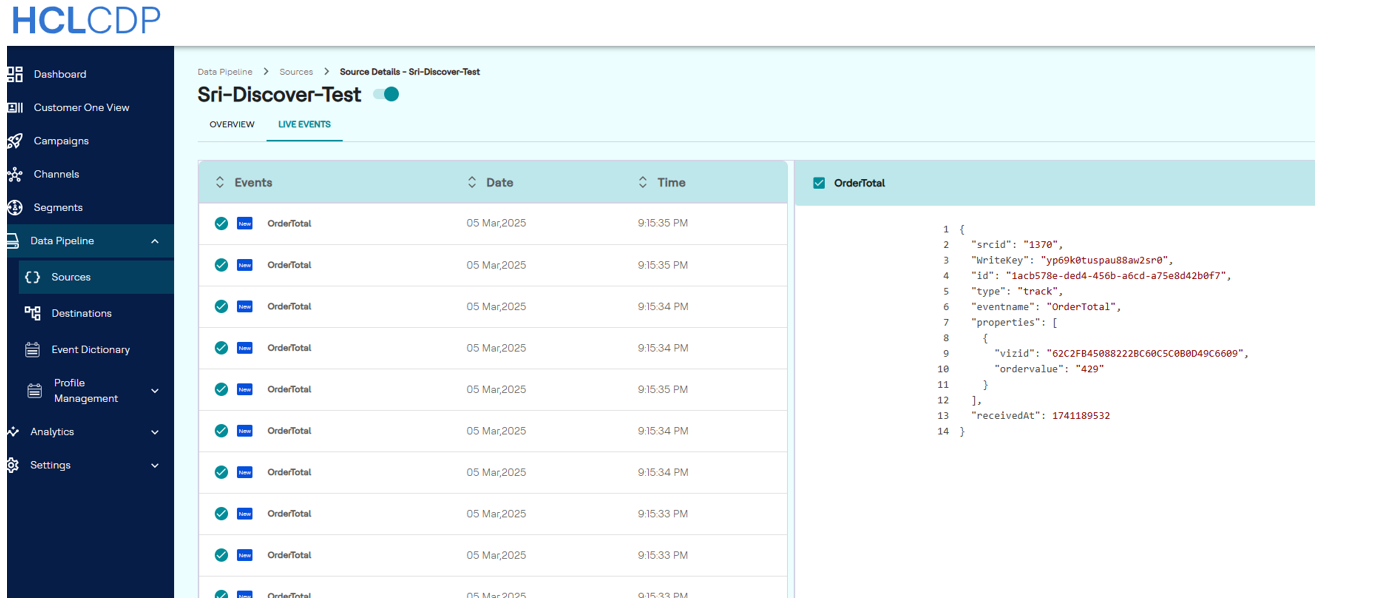

    #Event1=dcxeventid:1668,cdpeventname:OrderTotal,type:track,ordervalue:CustomVar3
    Here, Discover Event ID is 1668. CDP receives it as OrderTotal of type track and include ordervalue as an attribute.

  9. Test by firing sample events and confirming that CDP has received it.
