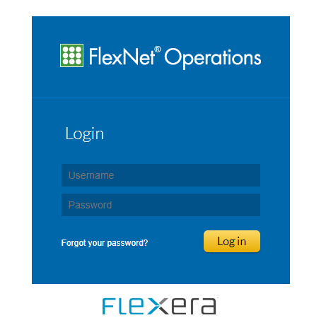

- Copy the following link and paste it in a browser address bar to access the
FlexNet login page:https://hclsoftware-fno.flexnetoperations.com/flexnet/operations/logon.do?logoff=true
Flexera Login dialog box
- Enter the authorized login credentials to access the Producer Portal Home page.

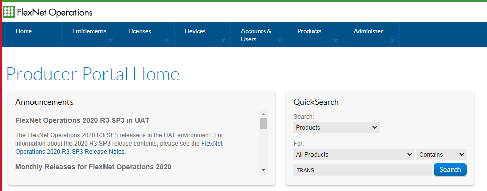

- Search for the required product by specifying the relevant keywords in the
QuickSearch section. The following image shows a keyword entered in the
search field, to find “HCL Z and I Emulator for Transformation.”
Producer Portal Home (QuickSearch for Products)

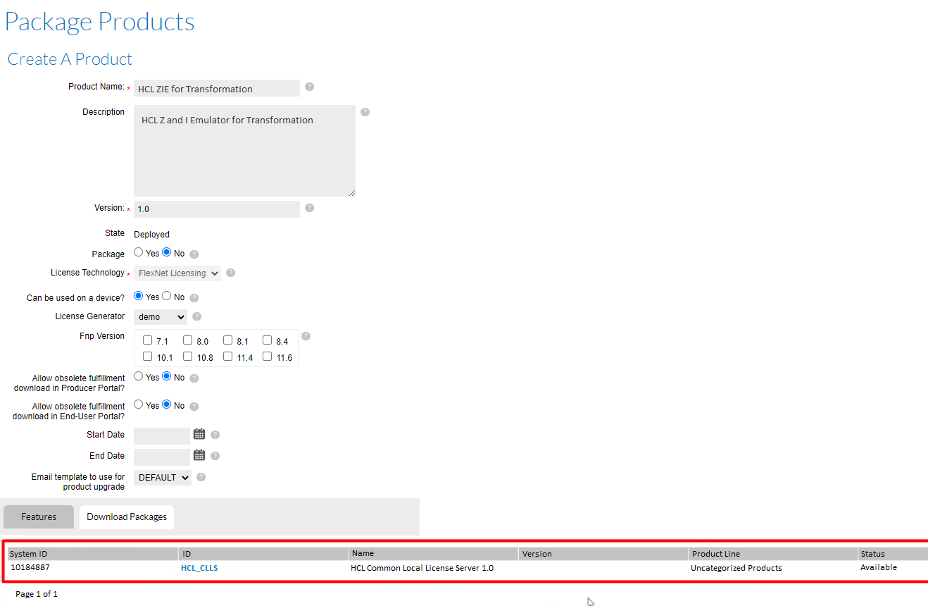

- In the “Create A product” panel that follows, click the Download
Packages tab to view and download the required packages. The
below image shows the options selected for downloading ‘HCL_CLLS.’
Package Products (Download Packages)
- Click HCL_CLLS to download the ‘HCL Common Local License Sever 1.0’ package to a user defined location.

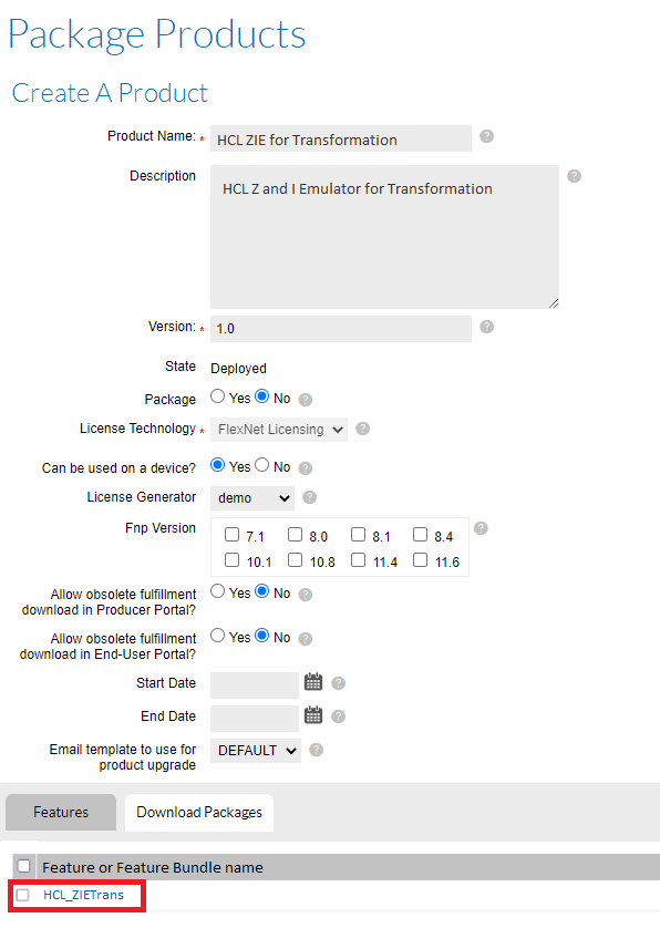

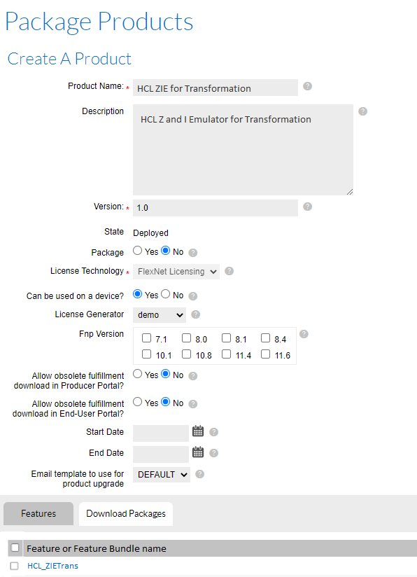

- Click the Features tab and download HCL_ZIETrans to download all the packages related to ZIETrans.

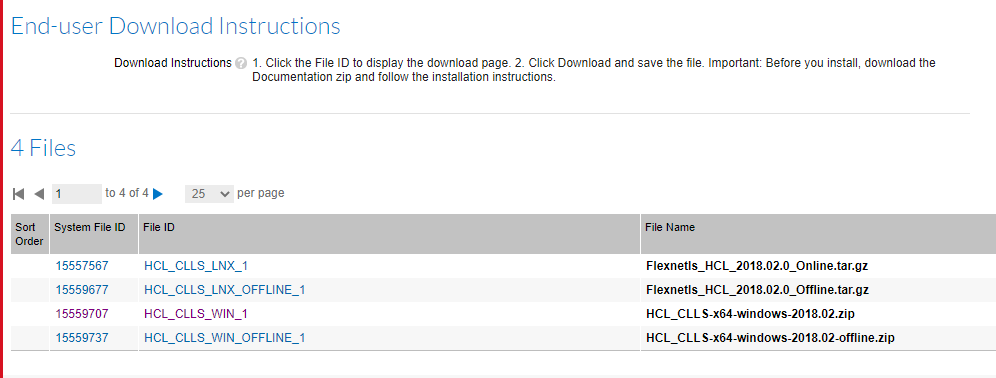

- In the HCL_CLLS package that is selected, the zipped packages shown in the
below image are present. Download the relevant installer, based on your OS
specification to connect to the Flexera License server.
Installer Packages in HCL CLLS
- For Windows users, download the HCL_CLLS_WIN_1 package.
- For Linux users, download the HCL_CLLS_LNX_1 package.
