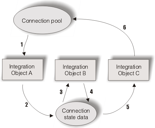

An Integration Object in a chain leaves the connection in a state (at a particular screen). After the Integration Object finishes running, another Integration Object that begins in that state (that is, at that screen) can run.
You can use chaining to break up a complex application into multiple tasks, each task represented by an Integration Object. You must ensure that the order of the Integration Objects is correct.
For example, if you have three Integration Objects in a chain (A, B, and C), then you must use A first, then B, then C. If Integration Object C is invoked before Integration Object B, then when C requests its connection, the connection is not available in the correct state, and the Integration Object fails.
- When Integration Object A begins to run, it retrieves the connection specified in the macro. If checkin screen enabled and a connection is available, the connection is already logged on and ready. If checkin screen is enabled, but a connection is not available, the connection is created and the connect macro (if specified) is run. If checkin screen is disabled, a connection is created and the connect macro (if specified) is run.
- Integration Object A runs the associated macro, then saves the connection and its current state for the next invocation. (You would have defined this state as the stop state label during Integration Object chaining).
- When Integration Object B begins to run, it retrieves a connection and its state from the connection state data because it is the middle Integration Object. You must have defined Integration Object B's start state label as Integration Object A's stop state label, which allows these Integration Objects to be chained.
- When execution completes for Integration Object B, the connection and its state are saved in the connection state data.
- Integration Object C also retrieves the connection from the connection state data. When Integration Object C begins to run, it retrieves a connection and its state from the connection state data because it is the last Integration Object. You must have defined Integration Object C's start state label as Integration Object B's stop state label, which allows these Integration Objects to be chained. Last-in-chain Integration Objects have no end labels because the connection is always returned.
- When checkin screen is enabled, the connection returns to the pool; otherwise, the disconnect macro (if specified) is run and the connection ends.
