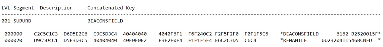

Dump format
Specifies the format of hexadecimal print output (for example, when you use Tape Print with Print format set to HEX). For an example of each format, see Selecting a display format.
Across
Display hexadecimal digits as 2 groups of 4 full words (resulting in 32 hexadecimal digits) followed by the EBCDIC character display to the right of the hexadecimal display. For example:

LVL Segment  Description     Concatenated Key
001 SUBURB                   BEACONSFIELD
 000000    C2C5C1C3  D6D5E2C6  C9C5D3C4  40404040    4040F6F1  F6F240C2 F2F5F2F0  F0F1F5C6    *BEACONSFIELD      6162 B2520015F*
 000020    D9C5D4C1  D5E3D3C5  40404040  40F0F0F2    F3F2F0F4  F1F1F5F4 F6C2C3D5  C6C4        *REMANTLE     002320411546BCNFD  *
