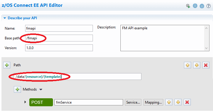

Check that the API URL matches the deployed z/OS Connect API
When creating an API using the z/OS Connect API Editor, the API creator chooses the base path and API path. The URL of the resulting API should have the following structure:
https://<your.server>:<port><base.path><API.path>
Figure 1. Specifying a base path and API path in the z/OS Connect API Editor
In this example shown in Specifying a base path and API path in the z/OS Connect API Editor, the URL should look similar to the following:
https://<your.server>:<port>/fmapi/data/MY.FILENAME/MY.TEMPLATE(TMPL)
Check that the URL you are using is correct.
