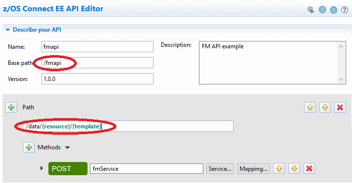

Check that the API URL matches the deployed z/OS Connect API
https://<your.server>:<port><base.path><API.path>
In this example shown in Specifying a base path and API path in the z/OS Connect API Editor, the URL should look similar to the following:
https://<your.server>:<port>/fmapi/data/MY.FILENAME/MY.TEMPLATE(TMPL)
Check that the URL you are using is correct.
