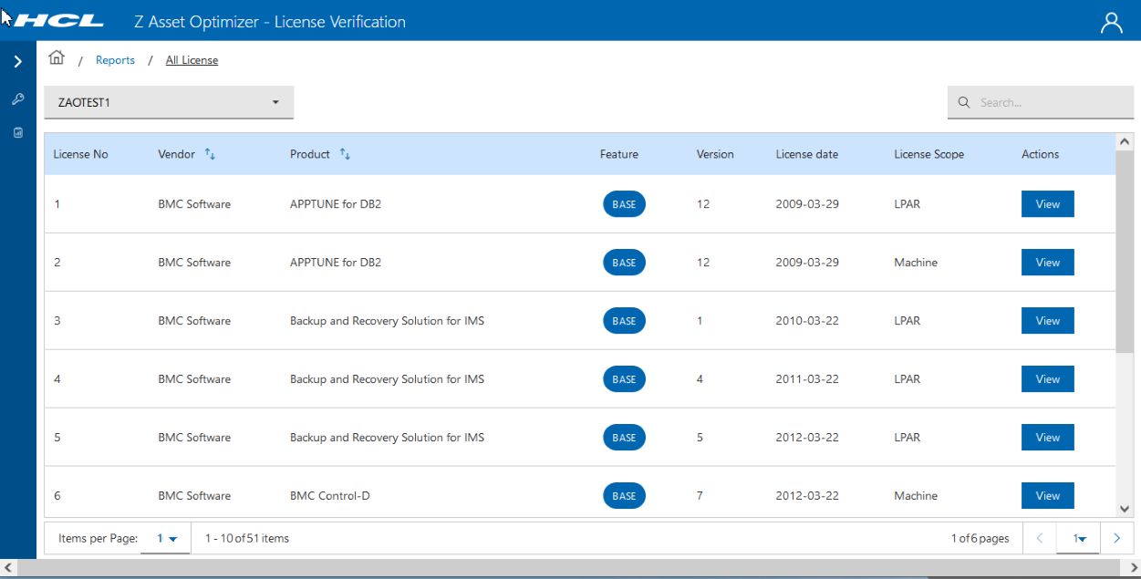

All License
The All License report displays raw license data imported using batch job HZASLICI.
All License report lists the imported license date. You can search on any field using Search button. The initial view is a summary of the imported licenses. The View button against each license gives you further detailed information:

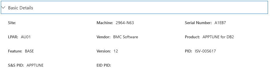

- Basic Details
Basic Details shows basic admin details about the license.

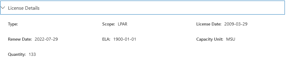

- License Details

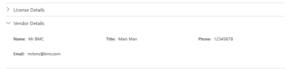

License Details shows details about the acquisition of the license.Note: Currently, only MSU is supported as Capacity Unit. - Vendor Details
Vendor Details shows contact information for the vendor the product was purchased from.

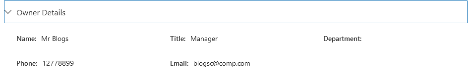

- Owner Details
Owner Details shows contact details for the licensed product at your company.

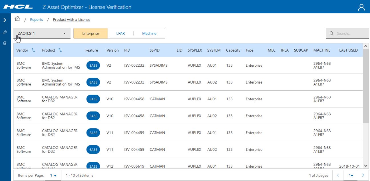

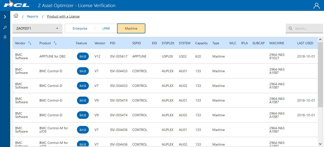

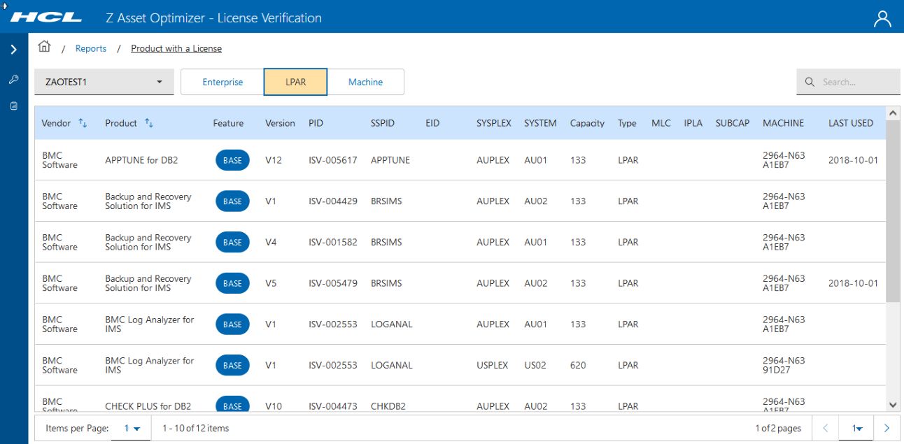

Product with a License
These reports show products indentified with a license.
Product with a License Enterprise
Product with a License LPAR
Product with a License Machine

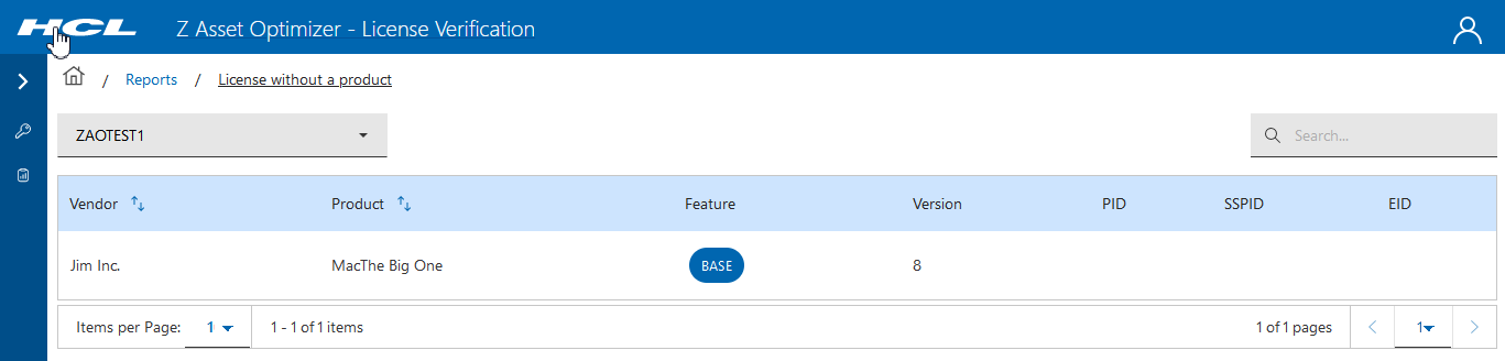

License without a product
This report shows licenses identified without a product.
- The product is not in the GKB (ZAO Knowledge database)
- The product has been identified but the version is UNKNOWN.
In this instance, you need to go back to ZAO and find the cause. It is possible you have a license for a product that has been removed and this license information also needs to be removed.

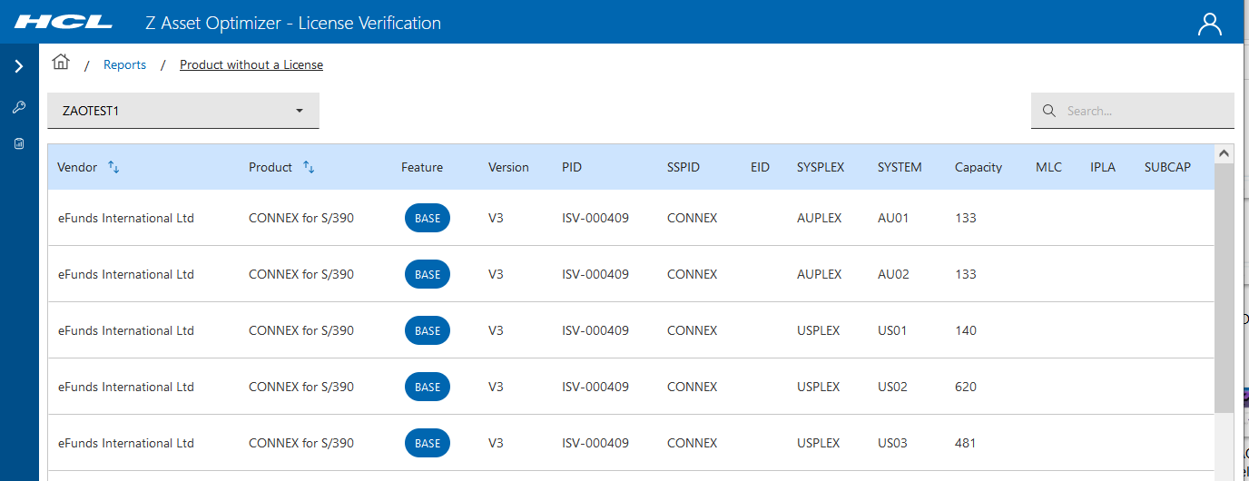

Product without a License
This report shows products identified that do not have a license.
Product without a License is a report that identifies products that do not have a license. It is possible that the products have been installed as a bundle with only some of these products containing a license.

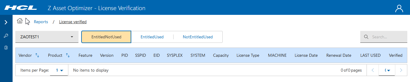

Entitled Not Used
EntitledNotUsed report shows you products that have a license, but are not being used. It could be possible this product is not longer required.

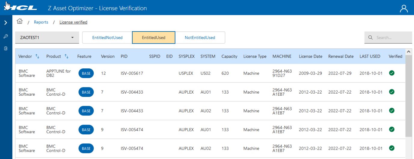

Entitled and Used
EntitledUsed report shows licensed products that are being used.

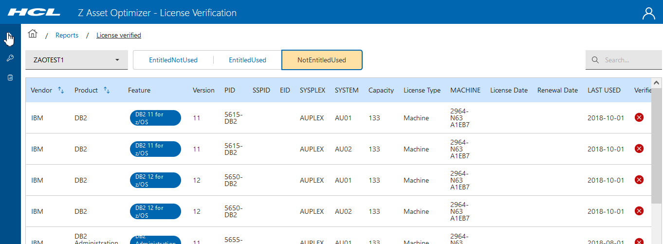

Not Entitled and Used
NotEntitledUsed is a report that shows you licensed products that are being used but that do not meet the verification criteria. Click on the red X button to see the reason why the product has not been verified. It is possible the capacity of the machine or LPAR has changed and does not match the license. It could also mean the renewal date has expired.
