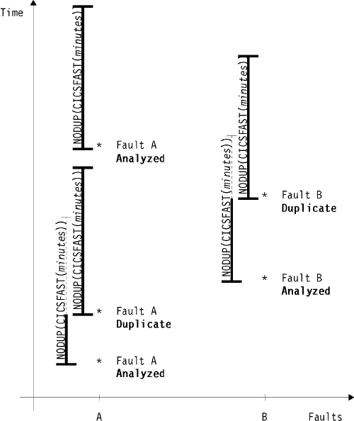

An illustration of this type of processing is shown in NoDup(CICSFAST) illustration, where:
  • All instances of fault A are considered duplicates of each other based on fault characteristics alone
  • All instances of fault B are considered duplicates of each other based on fault characteristics alone
  • The fault A characteristics do not match those of fault B
Figure 2. NoDup(CICSFAST) illustration
faoug006 Illustration of NoDup(CICSFAST) processing: Two types of CICS faults are being analyzed in real time, referred to as A and B. Initially, fault A occurs and is analyzed since it is not a duplicate. Then, within the number of minutes specified for the NoDup(CICSFAST) option since the first fault A occurred, another fault A occurs. This second fault A occurrence is deemed a duplicate of the first fault A. Then a fault B occurs, still within the number of minutes specified for the NoDup(CICSFAST) option since the second fault A occurred, and is analyzed since it is not a duplicate. Then, within the number of minutes specified for the NoDup(CICSFAST) option since the first fault B occurred, another fault B occurs. This second fault B occurrence is deemed a duplicate of the first fault B. Finally, beyond the number of minutes specified for the NoDup(CICSFAST) option since the second fault A occurred, another fault A occurs. This third fault A occurrence is analyzed since it is not a duplicate.
