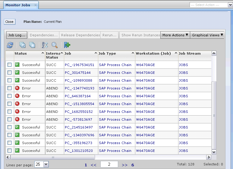

The table of results corresponding to the search criteria is displayed:
Figure 1. Dynamic Workload Console - Table of
results
Select a process chain job. For each process chain job,
a hyperlink named SAP Process Chain is displayed.
Distributed environment
The Job Type column displays SAP
Process Chain to help you identify SAP process chain jobs.
z/OS environment
The Advanced Job Type column displays SAP
Click the hyperlink for the job whose details you want
to display.

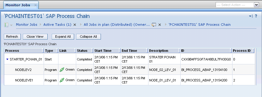

The details for the process chain are displayed:
Figure 2. Dynamic Workload Console -
Details of a process chain job HCL Workload Automation monitors
the process chain job until the job completes. The details shown reflect
the last monitoring process performed. Perform a restart of the process
chain indicating a refresh operation to synchronize the details with
those on the remote SAP system
to have the most updated information possible. If the process chain
contains local subchains, a hyperlink is displayed for each one. Click
the hyperlink you want, to display details about the corresponding
subchain job. Alternatively, you can display the process chain details
by clicking the hyperlink for the job and display the job properties
panel. Click the hyperlink shown under SAP Job Details. The
details for the process chain are displayed.
