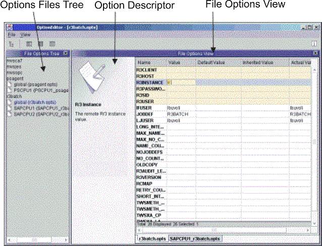

The Option Editor automatically loads all the existing global and local options files grouped by access method.
- File Options Tree
- Shows a list of all the existing options files, grouped by method.
- Option Descriptor
- Gives a description of the current selection.
- File Options View
- Displays the options of a selected file in any of the three available views.
- Simple

- Table
- Provides a tabular view of all the options for a selected file.
This is the default view. For each option the following columns are
displayed:
- Name
- The name of the option.
- Value
- The value specified in the file.
- Default Value
- The value used by the method if not specified in the options file or inherited.
- Inherited Value
- The value obtained from the global options file if inheritance is supported by the access method. For a detailed explanation, see Option value inheritance.
- Actual Value
- The value used at run time. The values are used in the order: value, if available; inherited value, if supported; default value.
- Text
- Displays an options file in the typical format, showing only the options that have a value. This view is generally used for preview purposes, because files are shown in read-only form. Password fields are shown encrypted.
Mandatory options are identified by a yellow background and are marked with an asterisk (*). Options that are not correctly entered are shown with a red background. The Option Editor performs only syntactic checks.
