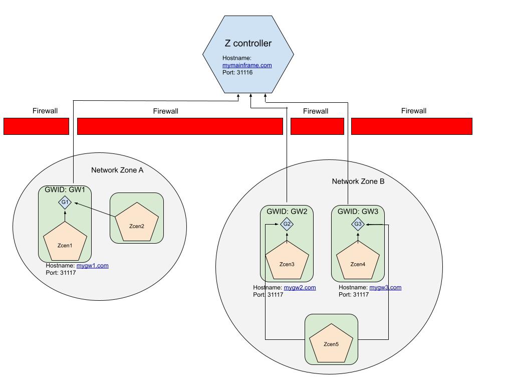

The following figure depicts the scenario environments:
figure depicting the master z controller behind a firewall and the groups of agents, each group in a different network zone and the use of local and remote gateways
Scenario 1: Same network zone
The workstations where you install the z-centric agents named Zcen1 and Zcen2 can communicate with each other and are located in the same network zone, but only one agent workstation (Zcen1) can connect to the Z controller.

Scenario 2: Different network zones
The workstations where you install the z-centric agents cannot communicate with each other and are in different network zones (Network Zone A and Network Zone B). However, one agent workstation in each network zone can successfully connect to the Z controller. In Network Zone B, two parallel gateways are configured.
