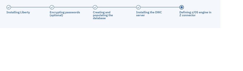

This picture describes the steps required for installing the Dynamic Workload Console. You are now at step 5: defining a z/OS engine in Z connector.
