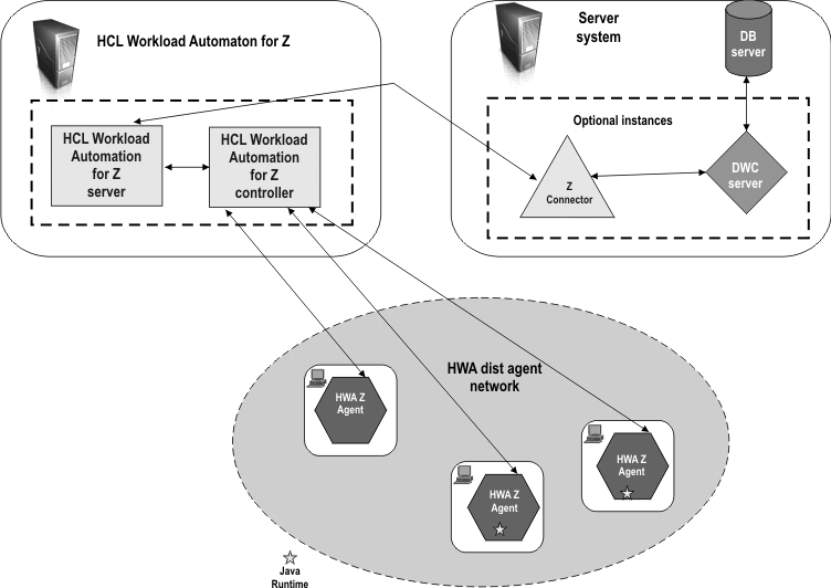

Static scheduling
The HCL Workload Automation Agents are installed on the distributed systems and are connected to the z/OS® system through the HCL Workload Automation for Z controller.
Static scheduling including job types with advanced options
Figure 1. Static end-to-end environment with Java™ run time installed in which you can run job types with advanced options
Graphic showing HCL Workload Automation Agents connected to the HCL Workload Automation for Z controller for static scheduling.
The HCL Workload Automation Agents are installed on the distributed systems with the Java™ run time, and are connected to the z/OS® system through the HCL Workload Automation for Z controller. Static end-to-end environment with Java run time installed in which you can run job types with advanced options shows a static end-to-end environment in which HCL Workload Automation Agents:
  • Without the Java™ run time installed, can run existing job types
  • With the Java™ run time installed, can run both existing jobs and job types with advanced options

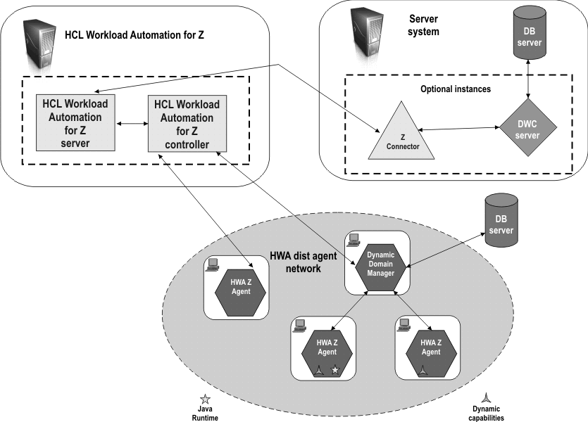

Dynamic scheduling
The HCL Workload Automation Agents are installed on the distributed systems with dynamic capabilities, and are connected to the dynamic domain manager. The dynamic domain manager is connected to the z/OS® system through the HCL Workload Automation for Z controller.
Dynamic scheduling including job types with advanced options
Figure 2. Dynamic end-to-end environment to run also job types with advanced options.
Graphic showing HCL Workload Automation Agents connected to the dynamic domain manager for dynamic scheduling.
The HCL Workload Automation Agents are installed on the distributed systems with dynamic capabilities and the Java™ run time, and are connected to the dynamic domain manager. The dynamic domain manager is connected to the z/OS® system through the HCL Workload Automation for Z controller. Dynamic end-to-end environment to run also job types with advanced options. shows a dynamic end-to-end environment in which HCL Workload Automation Agents:

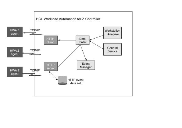

HCL Workload Automation Agents can be installed on the UNIX™, IBM® i, or Windows™ workstations where you run jobs scheduled from HCL Workload Automation for Z. After installation, you associate each agent to an HCL Workload Automation for Z workstation definition, so that it can be used as a target for HCL Workload Automation for Z jobs. The communication between the HCL Workload Automation Agent and HCL Workload Automation for Z controller is direct, through the HTTP or HTTPS protocol. If the connection is interrupted, the HTTP client retries to establish it until it is successful.
Process flow shows the process flow to submit and track jobs on HCL Workload Automation Agent workstations.
Figure 3. Process flow
Graphic showing the process flow to submit and track jobs on workstations
