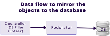

When a z/OS engine is registered to the Federator, data is mirrored to the configured database from the DB Filler subtask through the Federator, as shown in Mirroring data onto the database.
Figure 1. Mirroring data onto the database
When any job, job stream or workstation is created, updated, or deleted (either dynamically or by a daily planning EXTEND or REPLAN), the Z controller sends the related events to the Federator, which stores the information on the configured database. The objects that no longer are in the current plan are archived.

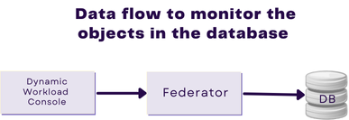

You monitor the objects on the configured database from the Dynamic Workload Console through the Federator, as shown in Mirroring data onto the database.
Figure 2. Monitoring data from the Orchestration Monitor
