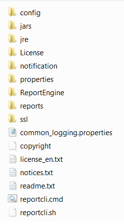

  1. The software needed to run batch reports is contained in a package named TWSBatchReportCli, in the TWSBatchReportCli directory. If you plan to run batch reports from within a scheduled job, extract the package file on one of the operating systems listed in the System Requirements Document at Dynamic Workload Console Detailed System Requirements.
    After you extract the package, you will have the following file structure:
    directory structure
