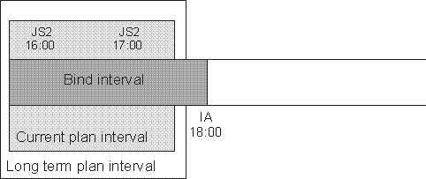

Scenario 1: The CP interval contains the input arrival of the
shadow job and JS2 occurrences exist.
Figure 1. Instance
to be bound if the shadow job input arrival is included in the CP
interval
Instance
interval shows, highlighted
in bold, the JS2 instance that more closely precedes the shadow job
input arrival. This instance is selected for the bind because the
input arrival is contained in the CP. The shadow job and the remote
job instance are associated. If, at a later time, a new instance of
JS2 that closest precedes the shadow job input arrival is submitted
ad hoc in the remote engine plan, the match with the JS2 instance
selected for the bind is not modified.

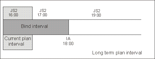

Scenario 2: The current plan interval contains the shadow job
input arrival, the JS2 instance that most closely precedes the shadow
job input arrival exist in the LTP but it was canceled from the CP.
Figure 2. Instance
to be bound if the instance that most closely precedes the shadow
The bind with OP2 is
established and a notification containing:
The information necessary to identify the OP2 instance in the
remote engine plan
The current status of that OP2 instance
is sent back to the HCL Workload Automation for Z controller,
the shadow job instance is updated with the remote job information,
and its status is updated accordingly.

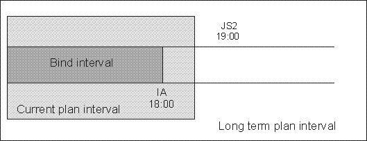

Scenario 3: The CP interval contains the input arrival of the
shadow job but no JS2 instance exists
Figure 3. The input
arrival of the shadow job is included in the CP but no instance to
bind exists
The
bind fails. A notification informing that the bind failed is sent
and the shadow job status is updated according to what you set in
the Complete if bind fails field.

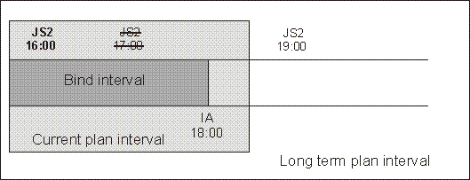

Scenario 4: The LTP interval contains the input arrival of the
shadow job and the CP does not yet include the closest preceding JS2
instance.
Figure 4. The instance
to be bound exists but it is not yet included in the CP
that the bind is established is sent back to the HCL Workload Automation for Z controller
and the status of the shadow job is set to READY-The bind was established.

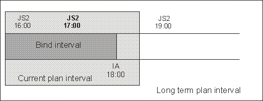

Scenario 5: The LTP interval still does not contain the input
arrival of the shadow job.
Figure 5. The LTP
interval still does not contain the input arrival of the shadow job
In this case, the bind request is put on hold on the
remote engine until the LTP is extended to include the shadow job
input arrival. Until then the status of the shadow job remains "READY-Waiting
for bind result".
