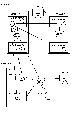

Multi-sysplex configuration with JESplex not matching sysplex
From a WLM point of view, this works as designed. To support this type of configuration, you must use the initial parameter statement OPCOPTS JESPLEX. that informs trackers of the identity of the multiple JESplex. The JESPLEX (List of system names) parameter provides the system names within the JESplex where the tracker belongs.

When the job is submitted on system A, tracker TA first checks the response of the WLM query if DB2x is available with its own JESplex list (A and B). For this reason, tracker TA understands that DB2x is not available in its own JESplex and therefore does not submit the job.
However, this is a static definition, therefore if you change configuration you have to stop the tracker, update the parameter, and restart the tracker. This problem can be avoided by supporting multiple JESplex in the same Sysplex, without involving the trackers but only following a best practice approach to define and use scheduling environments.

proceed as follows: - Associate MAS 1 with all the scheduling environments for jobs to be submitted on MAS 1
- Associate MAS 2 with all the scheduling environments for jobs to be submitted on MAS 2
- Assign a letter to each JESplex in the configuration. For example, in Multi-sysplex configuration: multiple JESplex SYSPLEX 1 JES MAS 1 can be identified with X, SYSPLEX 1 JES MAS 2 can be identified with Y, and JES3 GLOBAL with Z.
- Use the same name for the same resource throughout all MVS™ images. For example, DB2ACT should indicate, when set to ON, that the DB2® application is active on a specific image.
- Define for each JESplex the MASx resource, where x is the letter associated to the
JESplex. For example, resources MASX, MASY, and MASZ are to be defined as follows:
