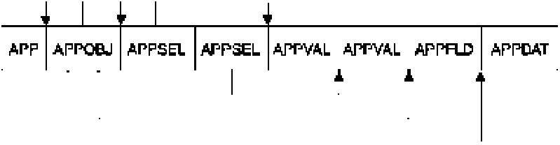

EQQUSIN buffer example is an example of the layout of a buffer (segments might be in other orders). This request uses 2 selection fields to locate an object and updates 1 field in the selected object. The arrows show the buffer parts that each section type points to. APP and APPOBJ point to related sections using triplet fields, which specify the offset, the length, and the number of the section type. APPSEL uses offset and length fields to point to an APPVAL section. All offsets are relative to the start of the buffer (offset 0).
Each section is described here in more detail.
