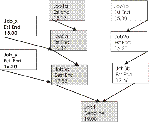

- The critical path is the chain of dependencies, leading to the
critical job, that is most at risk of causing the deadline to be missed
at any given time. The critical path is calculated using the estimated
end times of the critical job predecessors. Working back from the
critical job, the path is constructed by selecting the predecessor
with the latest estimated end time. If the actual end time differs
substantially from the estimated end time, the critical path is automatically
recalculated. Critical path shows the critical path through a critical network at a specific moment during the processing of the plan.
Figure 1. Critical path
At this time, the critical path includes Job3a, Job2a, and Job1a. Job3a and Job3b are the immediate predecessors of the critical job, Job4, and Job3a has the later estimated end date. Job3a has two immediate predecessors, Job2a and Job_y. Job2a has the later estimated end time, and so on.
