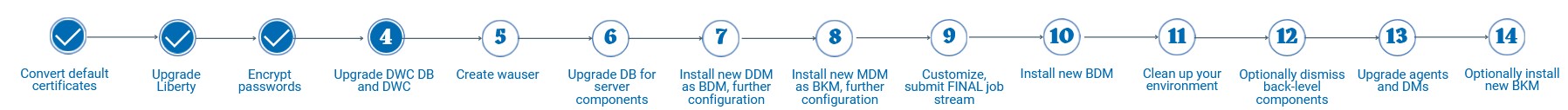

Upgrading the Dynamic Workload Console and its database
Upgrade the Dynamic Workload Console from version 9.5.0.x or 10.x to version 10.2.x. If you have several Dynamic Workload Console nodes in a cluster, upgrade all the nodes in the cluster.
When upgrading the HCL Workload Automation environment, it is a good practice to update the Dynamic Workload Console first. If you update the console, you can then use it to verify that your environment is working after updating the remaining components.
