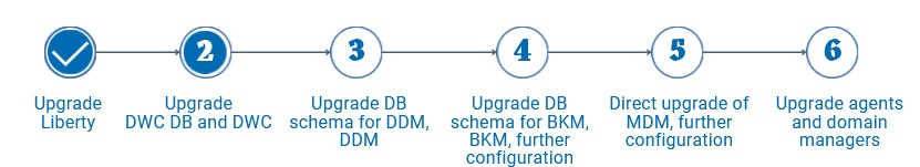

Performing a direct upgrade of the Dynamic Workload Console and its database
Perform a direct upgrade of the Dynamic Workload Console from version 9.5.0.x to version 10.2.x. If you have several Dynamic Workload Console nodes in a cluster, upgrade all the nodes in the cluster.
When upgrading the HCL Workload Automation environment, it is a good practice to update the Dynamic Workload Console first. If you update the console, you can then use it to verify that your environment is working after updating the remaining components.

What to do next
You have now successfully upgraded the Dynamic Workload Console. You can now proceed to upgrade domain managers using the procedure described in Performing a direct upgrade of the dynamic domain manager, its backups, and their database.
