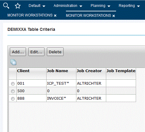

  4. Select an extended agent workstation in the table of displayed workstations, and click More Actions > Table Criteria... from the toolbar.
  5. The Table Criteria panel displays. From this panel you can add, delete, edit, or refresh criteria.
    Figure 1. The Table Criteria panel
    Panel: table criteria
  6. Specify the criteria:
    1. In Client, specify the client workstation of the SAP job.
    2. In Job Name, specify a filter to match a set of SAP jobs. Use the asterisk (*) wildcard character to match a set of jobs.
    3. In Job Creator, specify a filter to match a set of SAP job creator. Use the asterisk (*) wildcard character to match a set of jobs.
    4. Optionally, in Job Template, specify the template file that contains instructions for the interception collector about how to run the intercepted SAP job under control of HCL Workload Automation. For more information about template files, see Using template files.
    5. In Job Class, specify the class assigned to the job that represents the priority with which the job runs on the SAP system.
  7. Click OK.
