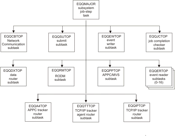

HCL Workload Automation for Z subsystem tasks shows the tasks that can be started as subtasks by the job-step task when HCL Workload Automation for Z is installed.
Figure 1. HCL Workload Automation for Z subsystem tasks
Figure showing the tasks that can be started as subtasks by the job-step task when HCL Workload Automation for Z is installed.
