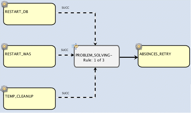

In the following example,
a join dependency, PROBLEM_SOLVING was inserted into the job stream
and aggregates three conditional dependencies, each related to different
predecessor jobs. Only one conditional dependency must be satisfied
to consider the PROBLEM_SOLVING join satisfied. The ABSENCES_RETRY
job follows the PROBLEM_SOLVING join and runs when at least one of
the three predecessor jobs completes successfully, thereby satisfying
the rule established on the join. If the join is not satisfied then
the ABSENCES_RETRY job is suppressed.
To set up the join in this example, complete the following steps:
- Add the RESTART_DB, RESTART_WAS, TEMP_CLEANUP, and ABSENCES_RETRY jobs to a job stream.
- Right-click the ABSENCES_RETRY job and select .
- In the properties for the join dependency, assign a name, PROBLEM_SOLVING.
- The rule to be applied to the PROBLEM_SOLVING join is at least one of the dependencies must be satisfied. Leave the default selection, At least 1.
- Right-click the PROBLEM_SOLVING join dependency in the Details view and select .
- Click Search to display all the jobs in the job stream.
- Select the RESTART_DB, RESTART_WAS, and TEMP_CLEANUP jobs and click Add.
- For each internal job dependency, edit the properties to
make it a conditional dependency.
- Select the Conditional Dependency check box.
- In Conditional Dependency Resolution Criteria, select Successor job runs if the predecessor job or job stream completes with any of these statuses.
- Select the SUCC check box.
- Save the changes.
