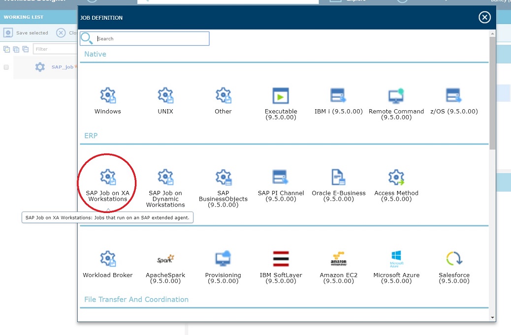

To create a new HCL Workload Automation job and then associate it to a new SAP job, follow these steps:
  1. From the Design menu, click Workload Designer page.
  2. Select an engine. The Workload Designer window is displayed.
  3. Click Create New, select Job definition and in the ERP category choose:
    • SAP Job on Dynamic Workstations
      For distributed systems only. This job definition can run on dynamic agent workstations, dynamic pools, and HCL Workload Automation Agent workstations.
      SAP Job on XA Workstations
      This job definition can run on extended agent workstations, which are workstations hosted by fault-tolerant agents or master workstations.
      New SAP job
    • SAP
      SAP
      For z/OS systems only. This job definition references an existing job on the SAP system and can run on dynamic agent workstations, dynamic pools, and HCL Workload Automation Agent.
  4. In the Properties pane, specify the properties for the SAP job definition you are creating using the tabs available. The tabs for each type of SAP job definition are similar, but there are some differences depending on the type of engine you selected and the type of workstation on which the job runs. For more detailed information about the UI elements on each tab, see the Dynamic Workload Console online help.
