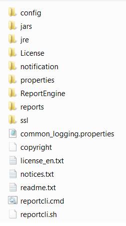

TWSBatchReportCli, in the TWSBatchReportCli directory.TWSBatchReportClican be downloaded from the Passport Advantage page, at the following URL: Product Requirements. If you plan to run batch reports from within a scheduled job, extract the package file on one of the operating systems listed in the System Requirements Document at Dynamic Workload Console Detailed System Requirements.After you extract the package, you will have the following file structure:
Because the native UNIX™ tar utility does not support long file names, if you are extracting the files on AIX®, Solaris, or HP-UX systems, ensure that the latest GNU version of tar (gtar) is installed to extract the files successfully.Note:- Make sure you run the following commands in the directory where you extracted the files:
