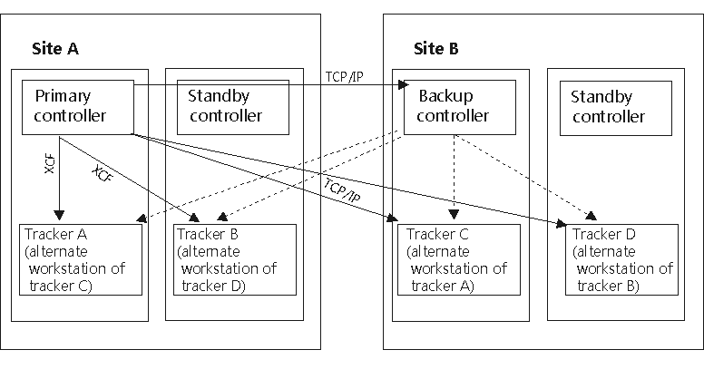

- The primary controller is connected to trackers A and B through XCF links. It is connected to the backup controller, trackers C and D through TCP/IP.
- The backup controller connects to trackers A, B, C, and D through
TCP/IP links when you issue the modify command
/F procname,BKTAKEOVERand the backup controller becomes the controlling system. - On the primary controller you set the following
