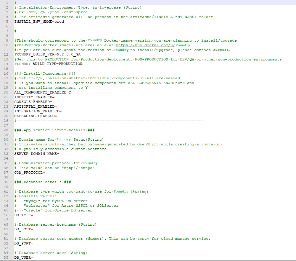

Configure the properties file
Extract the

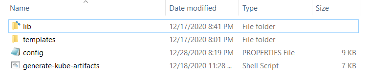

FoundryKube.zipfile. The OpenShift Foundry artifacts generation zip is organized as follows:
- lib: Contains dependent jars and helper bash functions
- templates: Contains the following files
- foundry-app-tmpl.yml: YAML template for Foundry deployments
- foundry-db-tmpl.yml: YAML template for Foundry Database schema creation
- foundry-services.yml: YAML template for Foundry services
- config.properties: Contains inputs that you must configure for the installation
- generate-kube-artifacts.sh: A user script that is used to generate required artifacts
As a result of executing the
generate-kube-artifacts.shscript, theartifactsfolder is created containing YAML configuration files. The YAML configuration files are generated based on theconfig.propertiesfile, and they must be applied later to deploy Volt MX Foundry on the OpenShift cluster. -
Update the
config.propertiesfile with relevant information.
For more information about the properties, refer to the following section.
config.properties

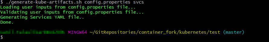

Generate the Foundry services by running the following command:
./generate-kube-artifacts.sh config.properties svcsTo generate the services configuration, you only need to fill the
INSTALL_ENV_NAMEproperty and the ## Install Components ### section in theconfig.propertiesfile.

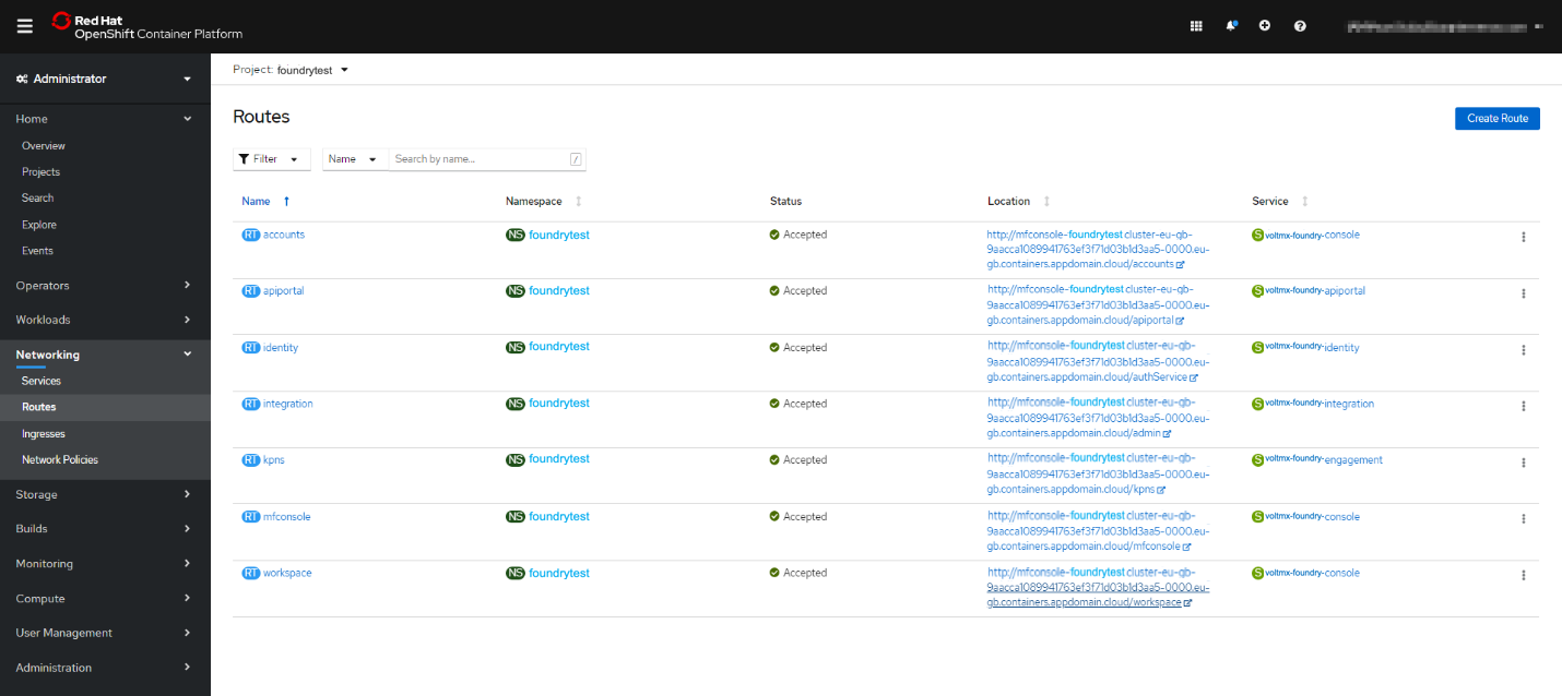

Follow either of the following steps to expose Foundry publicly.
- For development or proof of concept, using HTTP (non-SSL) routes and OpenShift generated hostnames is a quick way to get started. Create the routes from the OpenShift console or by running the following command:
Foroc expose service/<foundry-service> --path=<context_path> --name=<route_name><foundry-service>and<context-path>, refer to Context paths for Foundry components. The<foundry-service>is one of the Foundry services that were created earlier.
Executing theoc expose servicecommand assigns a unique OpenShift generated host name to the route that is created. The assigned host name can be identified by executing the following command:oc describe route <foundry-route>

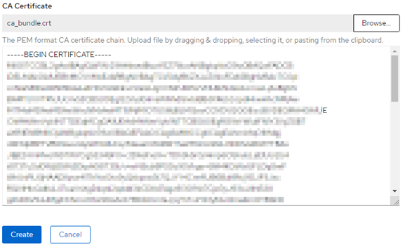

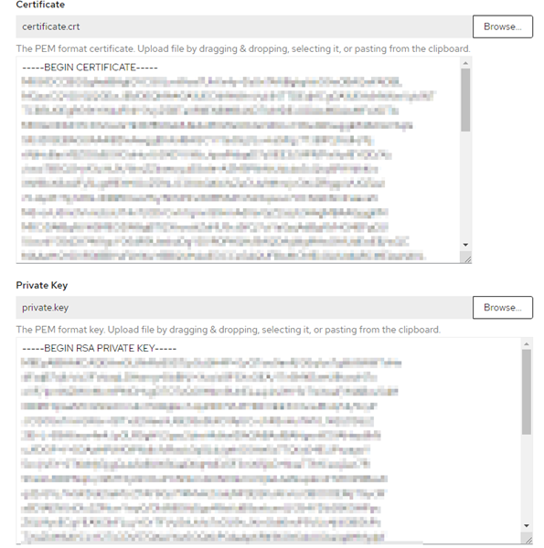

For production, Volt MX recommends that you use a custom domain name and terminate your SSL connection at the public load balancer. You need to obtain a custom domain name from a DNS provider, and SSL certificate and keys from a certificate authority. For more information, refer to Exposing apps with routes in OpenShift 4.
Note: The route types Reencrypt and Passthrough are not supported.
For a sample configuration, refer to the following screenshot.

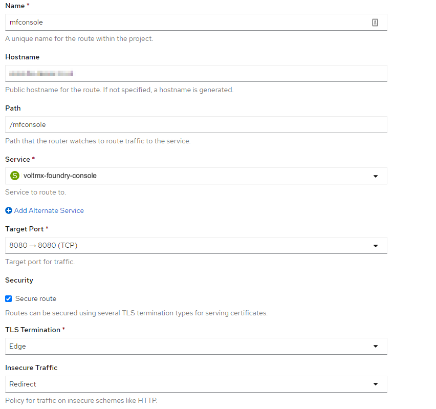

Configure Passthrough Routes
To configure the passthrough, you need to create a secure route for the Foundry component. To do so, follow these steps:
On the Create Route page, configure details for the Foundry component.
Note: The details in the screenshot are specific to the API Portal component and use a specific domain. Make sure that you change the details for other routes. For more information, refer to Context paths and Service Names for Fabric components.
Under Security, select the Secure Route check box.
From the TLS termination list, select Passthrough.
Provide the required values in the Application Server Details section of the config.properties file.

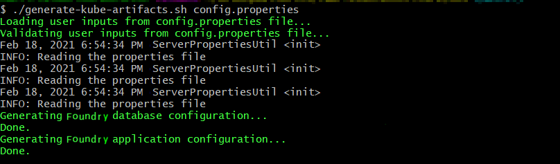

Generate the Foundry application and database configuration files by executing the following command.

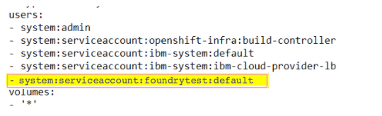

Edit the privileged security context by running the following command, and then add the service account that corresponds to your project.
oc edit scc privileged
For example: In the following screenshot, foundrytest is the project and default is the service account that is being used.
Note: Adding the service account to the privileged security context is only needed to create the database schema in the following step. After the execution of the Foundry database job is completed, you can remove the service account from the privileged security context.

Open a terminal console and navigate to the extracted folder.
Generate the Fabric services by running the following command:
INSTALL_ENV_NAMEproperty and the ## Install Components ### section in theconfig.propertiesfile. -
