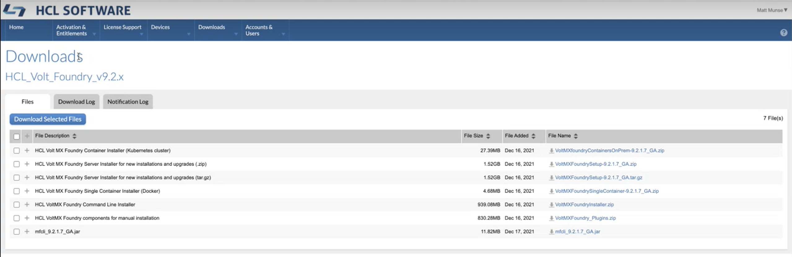

  • Download VoltMXFoundrySetup.tar.gz file from downloads site and extract the file. To download Volt MX Foundry installer from the community portal, follow these steps:
    1. Log in to Downloads. You can obtain a user name and password from your sales representative or partner. FNO_Foundry_Downloads
    2. Click the Files tab.
    3. Click on the specific file name to download the Foundry Installer file.
