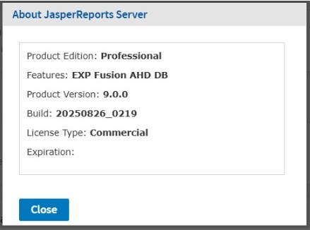

    c. Log in to the JasperReports Server. You can view the JasperReports Server version upgraded to V9.0.
    To check the upgraded version of the Jasper Reports Server, click the link specified in the footer immediately after the upgrade. The About TIBCO JasperReports Server dialog appears with upgraded details, shown below:

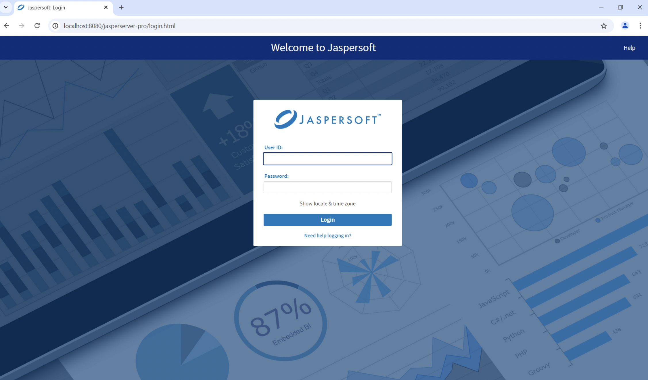

  1. Once the JasperReports Server is installed, the Install Complete window appears with the confirmation message. Select the Launch check box to launch the JasperReports Server.
    The Welcome to Jaspersoft page appears.
  2. Provide your default log-in credentials (username as superuser and password as superuser), and then click Login.

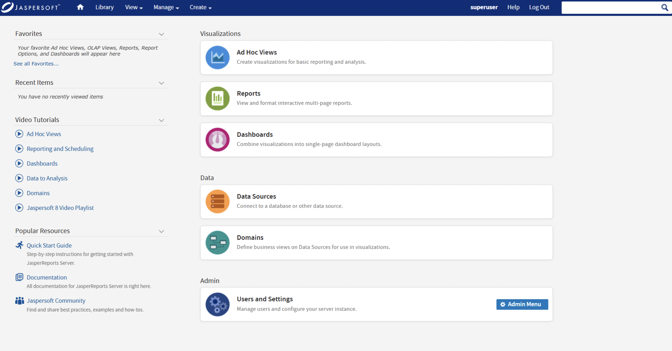

    The Getting Started page appears.
  3. On the Manage menu, click Users.

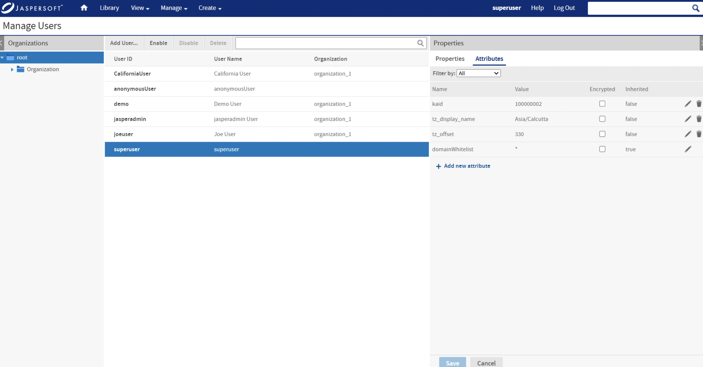

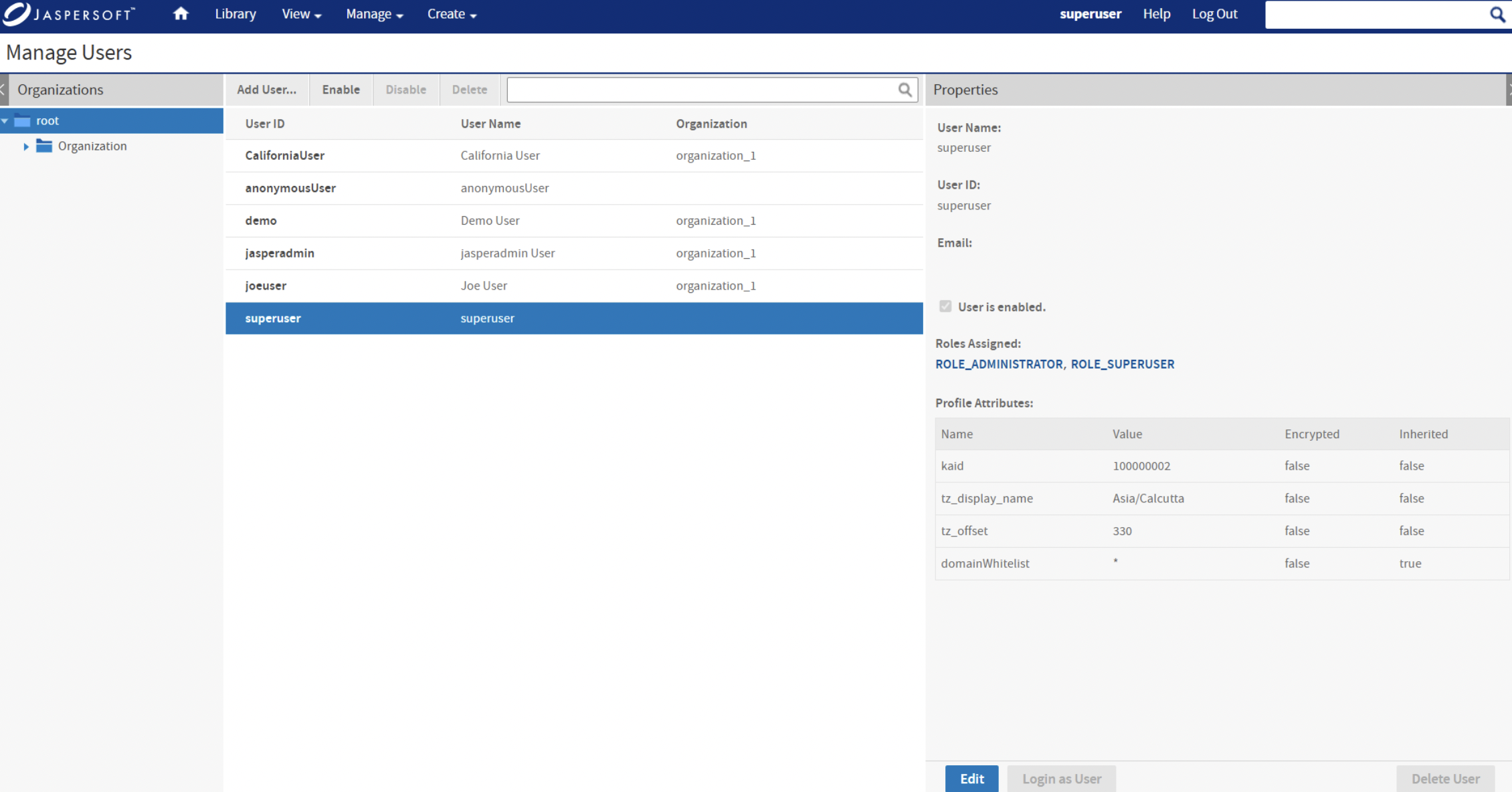

  4. From the Users list, click superuser, and then click Edit to continue.
  5. In the Attributes tab, click the Add button to add a row for the attribute.
  6. Add the following details:
    Attribute Name Attribute Value
    kaid - Volt MX Account ID. This value needs to match the Account Id generated by Volt Foundry Installer.
    The value of Account ID field generated for Volt Foundry Server can be viewed from the Settings page in Appservices. The Settings URL format is as follows:
    http://<mfconsoleIP:Port>/admin/console/config/configuration.html
    Example: 100000002
    Note: Volt Foundry 9.x, the default kaid value is always 100000002.
    tz_display_name - The timezone display name attribute appears on all reports as a footer indicating the timezone in which a report was generated. It is generally set to the Country/City Example: America/New_York
    tz_offset - The timezone offset attribute indicates the offset in minutes from UTC time. Date calculations are adjusted according to this attribute while running reports to ensure that time is based on a user's timezone.
    The offset contains sign (+ or -) with minutes to indicate if it is behind or ahead of UTC. For example: UTC - 5:00 for New York City would be set as -300 minutes varies for Japan which is at UTC + 9:00 would be set as 540 minutes.
    Example: +300
  7. Click Save to save the new attributes.
