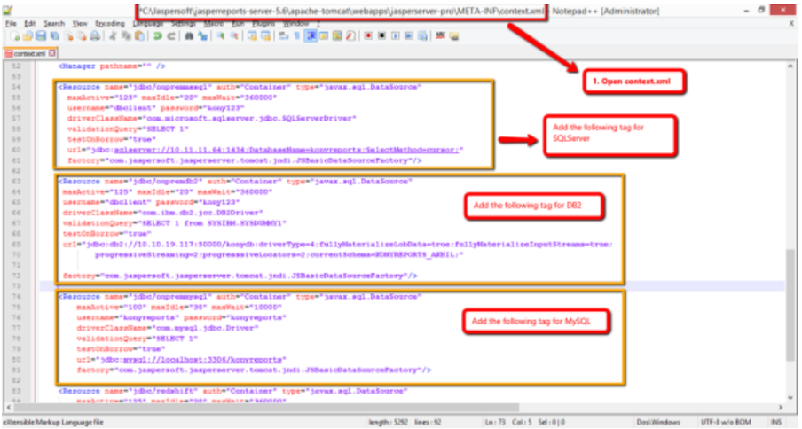

To set up the Jasper data sources, follow these steps:
  • From your Jasper install location, open the context.xml file.
    For example,\Jaspersoft\jasperreports-server-<8.2.0>\apache-tomcat\webapps\jasperserver-pro\META-INF\context.xml.
  • In the context.xml file, add the following JNDI configurations for the reports to access the reports database. You must replace the following fields with appropriate values to access the reports database details. For more details, refer to VoltMX Foundry_Installer_Guide > Installing Volt MX Foundry > Database Details window.

  • The following JNDI configuration is for the DB2 Server:

  • The following JNDI configuration is for the MSSQL:

  • The following JNDI configuration is for the MySQL:

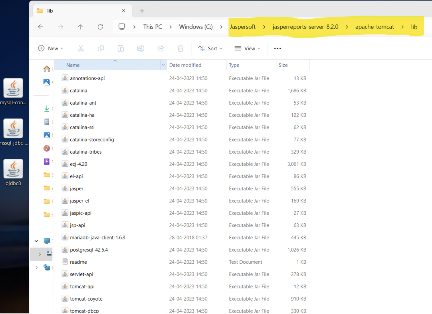

Note: Delete maraidb-java-client-2.5.3.jar in this path C:\Jaspersoft\jasperreports-server-8.2.0\apache-tomcat\lib
  • Add appropriate database drivers into the  \Jaspersoft\jasperreports-server-<8.2.0> or <7.9.2> or <7.1.0> or <6.2.0> or <6.0\apachetomcat\lib folder.
