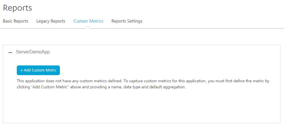

The Volt MX Foundry Integration Service App Services enables a user to define custom metrics. Administrator can view Custom Metrics under Reports tab:
  • Custom Metrics - enables users to add or delete metrics that they intend to send from the application. The Custom Metrics page shows a list of applications deployed to Volt MX Foundry Integration Service. If a user deploys an application to Volt MX Foundry Integration Service, it appears in the Custom Metrics page.

The Custom Metrics page allows an application developer to define the metrics for an application. Each metric is identified by a key that has to be unique within the application. There are six types of data: String, Boolean, Long (Integer), Double, Date, and Timestamp. The page shows all applications deployed to Volt MX Foundry Integration Service. To add custom metric parameters for an application, under Custom Metrics tab in the Reports section of the application, click on + Add Custom Metric button.
For applications that already have custom metrics defined, clicking on Add + will show the list of Parameter Names, Data Type, and Default Aggregation function.
The application can send multiple key-value pairs that will be stored as custom metrics for reporting purposes. The user must register each key sent by the application and provide the Data Type and Default Aggregation values.

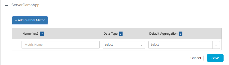

To create a custom metric, follow these steps:
  1. Click Add Custom Metric. The following pane appears.
  2. Enter a name in the Name (key) area. Each metric is identified by a key that must to be unique within the application. The application code must use the same Name for sending data in the key-value pairs in JSON string . The key is case insensitive.
  3. Select a Data Type from the list. The available values are Long (integer values), Double (values with decimal points like 12.5), String, and Date.The data type mentioned here must match the data type sent from the application for the metric name.
  4. Select a Default Aggregation from the list. The Default Aggregation is the cumulative function you apply to the data while building the application. The available values are Sum, Average, Highest, Lowest, Count, and Distinct Count. Default Aggregation functions are only applicable for Long and Double.
  5. Click Save. The parameters will be defined and saved under the application name. The custom metrics defined will be sent to the application to collect data.
  6. Click Cancel to cancel adding custom metrics to the application.
